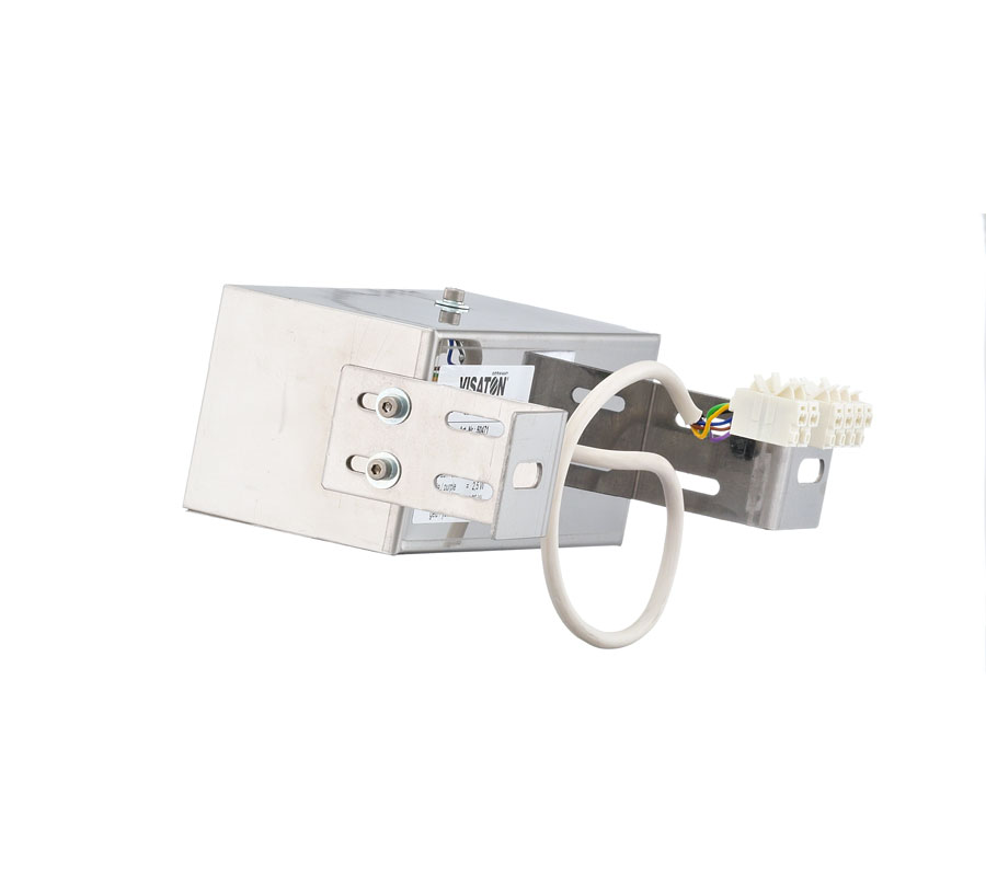

UL 7 N MB
Mounting bracket for the UL 7 N - 100 V cabinet speaker (Art.-No. 50471). With this bracket, the UL 7 N - 100 V can be used as a replacement for Visaton UL 99 or Isophon DL 94.
