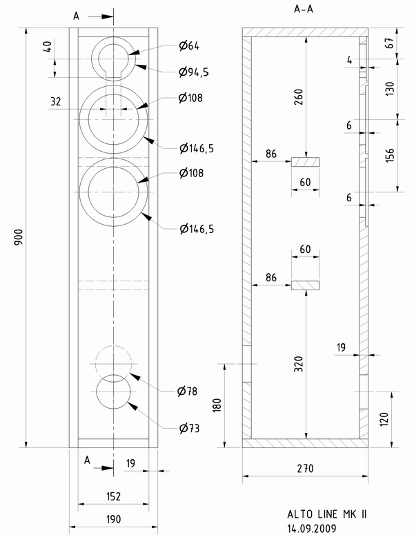

        Building instruction
Exploded drawing
Assembly
Simply glue the boards together (butt-jointed) as shown in the parts list. After that, cut out the openings for the speaker drivers, the bass reflextube (front) and the terminal connections (rear).
Inner damping
The damping of the cabinet uses three mats of damping material rolled loosely, pushed into the cabinet through a bass opening and arranged uniformly above the bass tube.
Cabinet parts list for 1 box
Parts
              Size (mm)
            Quantity
      Material: 19 mm chipboard or MDF
      Front and rear panel
              862 x 152
            2
      Side panel
              900 x 270
            2
      Top and bottom panel
              270 x 152
            2
      Braces
              60 x 152
            2
