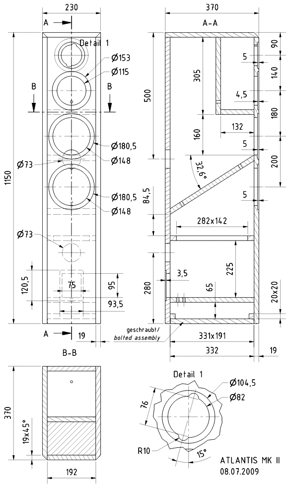

Assembly
The cut sections of the cabinet, except for the base, are glued as shown in the drawing. Bevels can be cut with an adjustable jigsaw or circular saw. Since it is not always easy to set the exact angle, it is worth making a couple of trial cuts on spare wood.
The cabinet is made with a double floor to enable the crossover to be positioned outside the speaker housing chamber itself. The base to which the crossover is attached is then screwed to the cabinet from below. The pre-drilled cable holes inside the housing must be filled afterwards using hot-melt glue or silicon mastic.
Inner damping
One mat of damping material are required for the mid-range cabinet. The remaining 2 mats are in each bass cabinet. Leave the space behind the bass vent free of damping.
Cabinet parts list for 1 box
Teile
Maße (mm)
Anzahl
Material: 19 mm Spanplatte oder MDF
Front / Rückwand
1131 x 192
2
Seiten
1131 x 370
2
Deckel
230 x 370
1
Trennwand
407 x 192
1
Zwischenboden / Versteifung
332 x 192
2
MT Boden
132 x 192
1
MT Rückwand
305 x 192
1
Boden
331 x 191
1
Material:
Holz
Leisten
20 x 20 x 192
2
