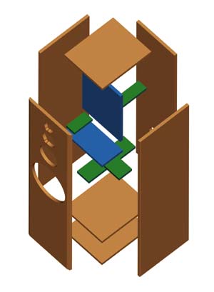

Exploded drawing
Assembly

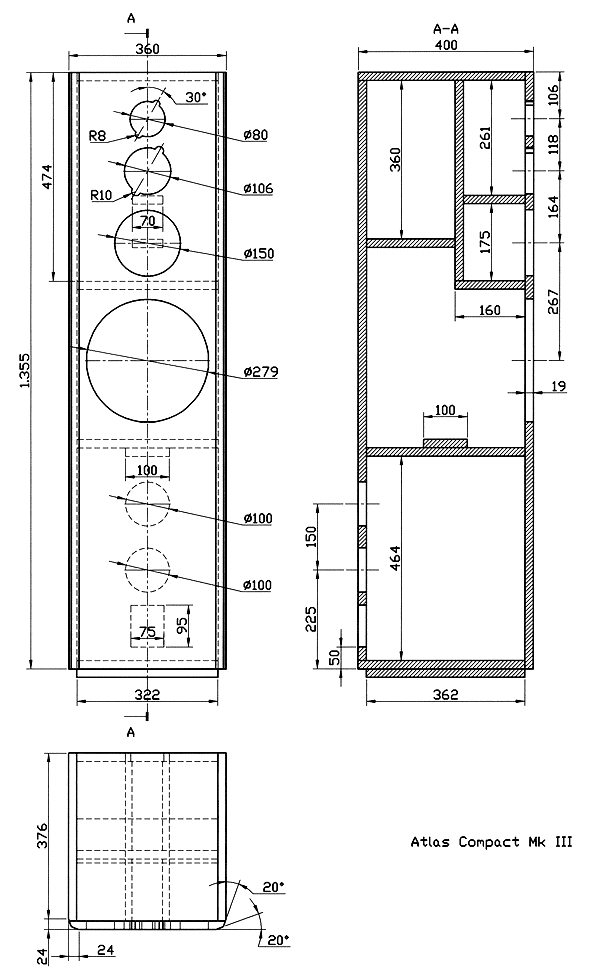

Within the large subwoofer cabinet, there is a separate chamber for the mid-bass unit. The domes are also mounted in this section, which is reinforced with a narrow strut. Three 8-mm holes will have to be drilled for the cables. The two large openings in the rear wall are for mounting the bass reflex tubes while the rectangular one is for the terminals. The crossover is mounted on the wall behind the bass vent.
Inner damping
Die Bedämpfung wird nach Plan vorgenommen. 2 Matten werden in das Mitteltongehäuse gestopft. 10 Matten kommen in das Tieftongehäuse.
Cabinet parts list for 1 box
Parts
Size (mm)
Quantity
Material: 19 mm chipboard or MDF
Top and bottom panel
381 x 322
2
Side panel
381 x 1355
2
Rear panel
1317 x 322
1
Front panel
1355 x 360
1
Brace
322 x 100
1
Brace
362 x 100
1
Midrange rear panel
455 x 322
1
Midrange bottom panel
160 x 322
1
Brace
141 x 70
1
Brace
202 x 70
1
Base
322 x 362
1
