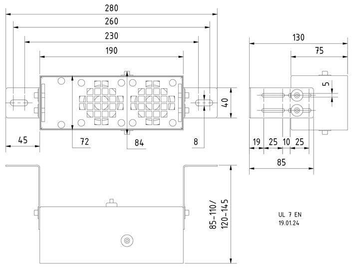

Technical Data
Sketch
Directivity pattern
Nominal impedance Z 1.0/2.0/3.3/8.0/12.5 kOhm
Frequency response 300-20000 Hz
Mean sound pressure level 90 dB (1 W/1 m)
Opening angle (-6 dB) 90°/4000 Hz hor. / 52°/4000 Hz vert.
Net weight 1.45 kg
Transformer matching 10 W/5 W/3 W/1.25 W/0.8 W
Max. sound pressure level 100 dB (10 W/1 m)
Connections Ceramic screw terminals
Length of cable 04 m
Protective system IP 33 A EN54 IP 54 *)
Temperature range –25 ... 70 °C
