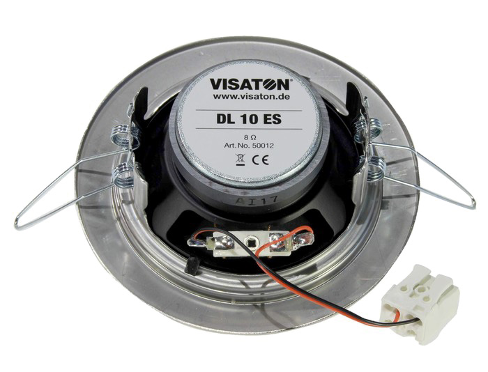

10 cm (4") ceiling-mounted speaker made of stainless steel with brushed finish. Suitable for use in all types of hollow ceilings. Easy fitting in round cut-out using spring arms, electrical connection by spring-loaded terminal clips. A compact solution for home and professional use with good sound qualities. ? Functionally at low temperature according to EN 60068-2-1 (-40 °C; 96 h) ? Up to the standards of the Germanischer Lloyd (requirements for electrical equipment / low temperature) Speaker cabinet systems for concrete ceilings are available from KAISER, 58579 Schalksmühle, Germany. The KompaX cabinet series is suitable for our ceiling speakers. Some additional front parts maybe necessary (front rings, mineral fibreboard etc.). More details are available on the Homepage of KAISER (Housing for lamps and loudspeakers). In order to get more detailed information, press the "Technical information" button of the particular product. Fire protection housing systems (F30) are also available (FlamoX).

Technical Data
Sketch
Directivity pattern
Nennbelastbarkeit 20 W
Musikbelastbarkeit 30 W
Nennimpedanz Z 8 Ohm
Übertragungsbereich (-10 dB) 75-20000 Hz
Mittlerer Schalldruckpegel 86 dB ( 1W/1 m)
Abstrahlwinkel (−6 dB) 82°/4000 Hz
Grenzauslenkung +/-2.5 mm
Resonanzfrequenz fs 140 Hz
Magnetische Induktion 0.7 T
Magnetischer Fluss 130 µWb
Obere Polplattenhöhe 4 mm
Wickelhöhe 6 mm
Schallwandöffnung 110 mm
Gewicht netto 0.39 kg
Schalldruckpegel 90 dB (1 W/1 m) @ 2100 Hz
Farbe stainless steel with brushed finish
Anschlüsse Spring terminals
Einbautiefe 43 mm
Länge des Anschlusskabels 0.1 m
IP Schutzklasse IP 54 *)
Temperaturbereich -40 ... 110 °C
