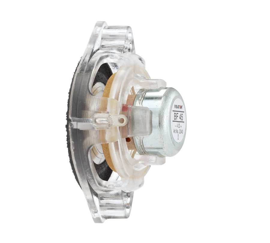

4.5 cm (1.8") fullrange speaker with aluminium diaphragm and transparent plastic basket with two mounting holes. Balanced frequency response and very good low range reproduction. Suitable for applications where slim construction and good music and speech reproduction are requested.

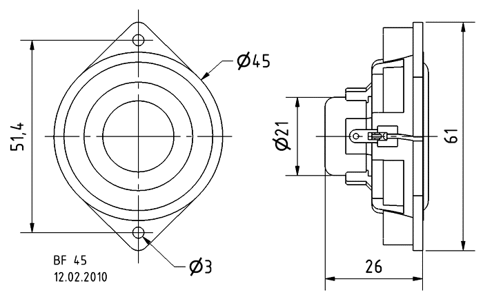

Technical Data
Sketch
Directivity pattern
Nennbelastbarkeit 4 W
Musikbelastbarkeit 8 W
Nennimpedanz Z 4 Ohm
Übertragungsbereich (-10 dB) 90–20000 Hz
Mittlerer Schalldruckpegel 79 dB (1 W/1 m)
Resonanzfrequenz fs 160 Hz
Obere Polplattenhöhe 3 mm
Schwingspulendurchmesser 17 mm
Wickelhöhe 4 mm
Schallwandöffnung 45 mm
Gewicht netto 32 g
Anschlüsse Solder lugs
Temperaturbereich -25 ... 70 °C
