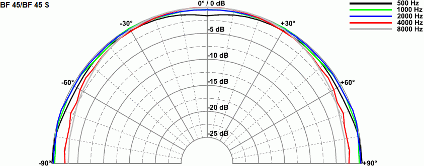

Directivity pattern

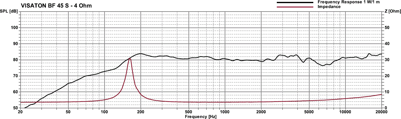

Frequency response 90–20000 Hz
Mean sound pressure level 79 dB (1 W/1 m)
Resonance frequency fs 160 Hz
