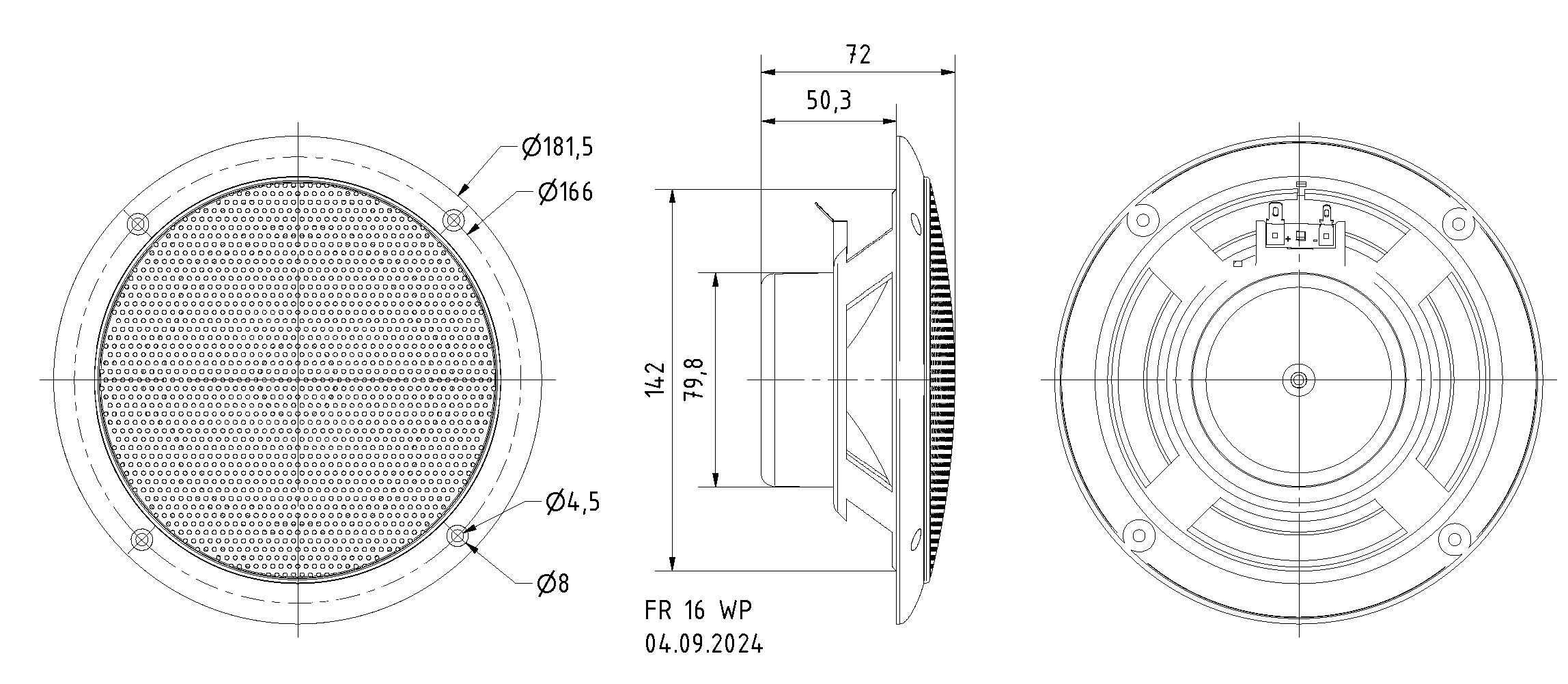

Sketch

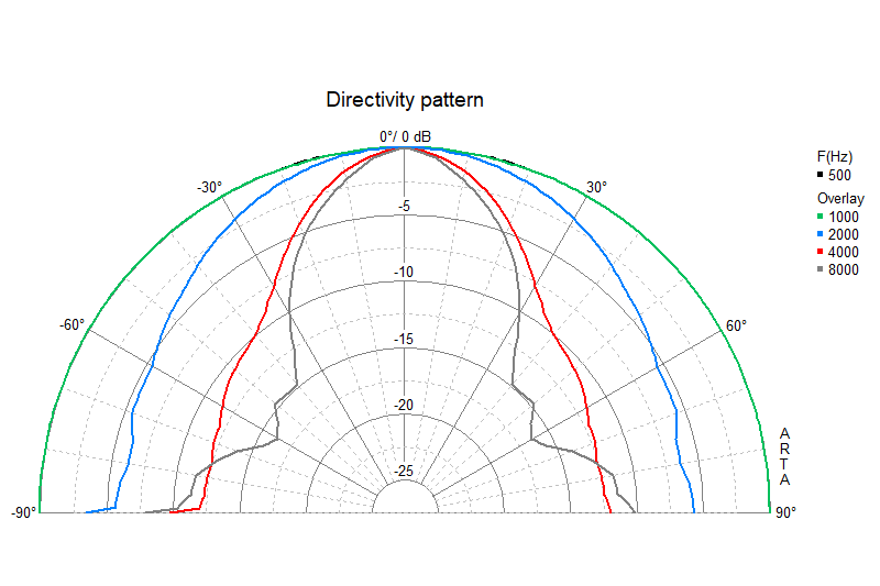

Directivity pattern
Rated power 30 W
Nominal impedance Z 4 Ohm

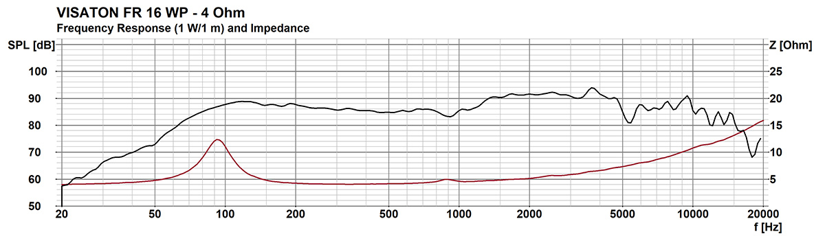

Frequency response 60–15000 Hz
Mean sound pressure level 86 dB (1 W/1 m)
Opening angle (-6 dB) 46°/4000 Hz

Resonance frequency fs 85 Hz

Height of front pole-plate 4 mm
Voice coil diameter 20 mm
Height of winding 5.3 ±0.4 mm
Cutout diameter 143 mm
Net weight 0.46 kg
D.C. resistance Rdc 3.7 Ohm

Connections 4.8 x 0.8 mm (+)/2.8 x 0.8 mm (-)
