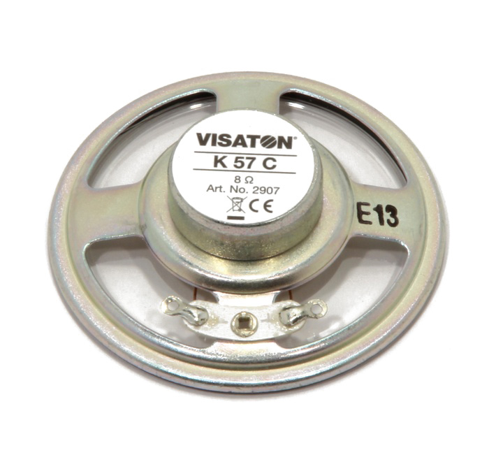

K 57 C - 8 Ohm
Art. No. 2907
5.7 cm (2.2") miniature speaker with waterproofed, transparent Mylar membrane and Neodymmagnet. Light weight. Low installation hight. Can be used outside and at critical enviroments. Suitable as signal speaker at electric mashines. Good speech, intelligibility.

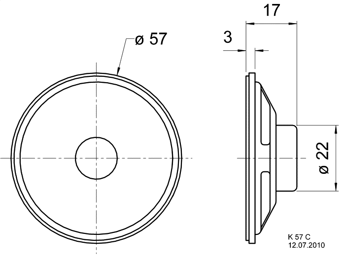

Sketch

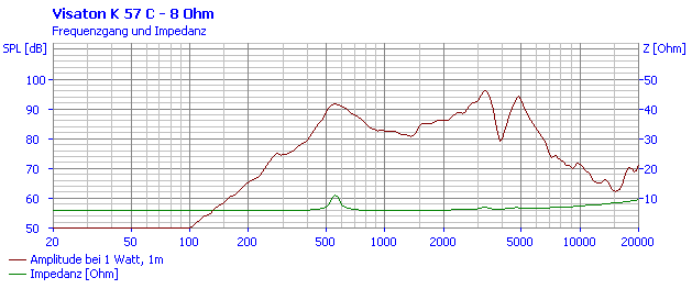

Directivity pattern
Rated power 2 W
Maximum power 3 W
Nominal impedance Z 8 Ohm
Frequency response 350–6800 Hz
Mean sound pressure level 87 dB (1 W/1 m)
Resonance frequency fs 550 Hz
