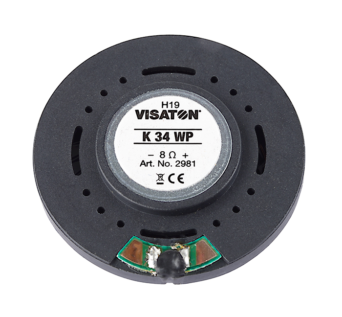

Art. No. 2981
3.4 cm (1.3") miniature speaker with a plastic basket and plastic diaphragm. Ballanced frequency response and good voice reproduction. Particularly well suited to outdoor applications and where ambient conditions are generally unfavourable (e.g. high humidity).
Typical applications
  • Monitoring speaker for electronic devices
  • Monitoring speaker for outdoor systems
Technical Data
Sketch
Rated power 1 W
Maximum power 2 W
Nominal impedance Z 8 Ohm
Frequency response 320–20000 Hz
Mean sound pressure level 79 dB (1 W/1 m)
Resonance frequency fs 570 Hz
Net weight 0.006 kg
Connections Solder joints
Protective system IP 64 *)
Temperature range −40 ... 70 °C
