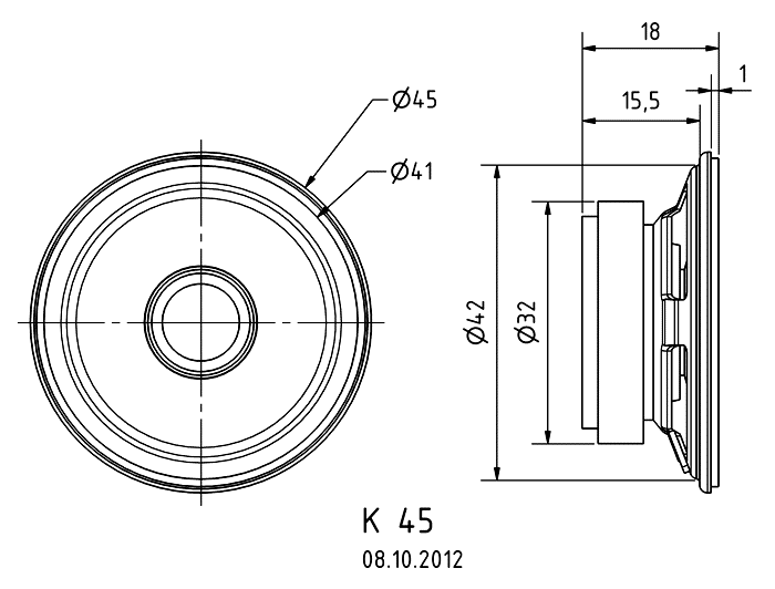

Technical Data
Sketch
Amplitude & Impendance Frequency
Rated power 1 W
Maximum power 2 W
Nominal impedance Z 8 Ohm
Frequency response 300–14000 Hz
Mean sound pressure level 83 dB (1 W/1 m)
Resonance frequency fs 520 Hz
Height of front pole-plate 1.5 mm
Voice coil diameter 14 mm
Height of winding 2.5 mm
Cutout diameter 41.5 mm
Net weight 0.046 kg
Connections Solder lugs
Temperature range –25 ... 70 °C
