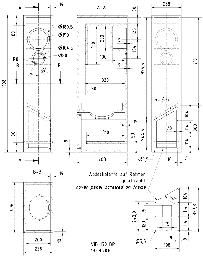

Building a double-sided ventilated bandpass cabinet isn't as facile as for example a closed box. However, if one follows the instructions step by step, even this build can be accomplished without problems.
Beginning with one side panel, the baffle, the upper rear panel, the top panel and the bottom panel as well as the reflex channels and the panels for the midrange cabinet are glued on top. A hole of about 6mm in diameter is to be drilled into the midrange cabinet to wire the AL 170 - 8 Ohm (seal properly!). In order to keep the width of the box as small as possible, the separation wall, on which the TIW 200 XS - 8 Ohm is mounted, is tilted through 30°. This board is previously provided with two triangular plates to ensure the right mounting angle. Again, a hole of about 10 mm must be drilled through the mounting plate of the woofer to rout the wires for the three chassis. This hole also needs to be sealed well. The whole construction can now be slid into the box and glued on.
Before doing so, it is strongly recommended to doublecheck the exact position of the woofer's cutout. A displacement of only 1 or 2 millimeters to the top or the bottom can already cause the TIW 200 XS - 8 Ohm to not fit any more. A trial fitting of the woofer should be carried out by all means before gluing the frame into the cabinet. Moreover, the mounting holes must be drilled and the screws should be screwed in and out once to facilitate the mounting of the woofer later under the cramped conditions inside the cabinet. Finally, the mounting frame for the lower rear panel is glued in with a recess of 19 mm, and the second side panel can be attached.
The chamfer is discontinued around the reflex channels only for optical reasons. If no router is on hand, the chamfer can also be cut continuously over the whole height of the box with a circular saw.
Optionally, a wooden baffle can be added as can be seen in the picture (here: Acacia). The rest of the build is not affected by this addendum, except for the chamfer and the recesses of the chassis, which now are located on the additional front plate. For optimal clearance it is well proven to mill out the holes for the reflex channels with a profile miller after attaching the front plate. Lastly, a shadow gap makes for a neat transition between the corpus and the baffle.
Through the opening at the rear side of the box, the woofer can later on be mounted with hexagon socket screws and a small, cranked hexagon socket key. The crossover network is seated on top of the lower reflex channel. After the assembly is completed, the cabinet is sealed by screwing on the detachable rear panel with 9 hexagon socket screws and some sealing tape.

Cabinet parts list for 1 box
Parts
Size (mm)
Quantity
Material: 19 mm chipboard or MDF
Side panel
1108 x 408
2
Top/Bottom panel
200 x 408
2
Front panel
200 x 970
1
Upper rear panel
200 x 826
1
BR-channel rear/below
200 x 310
2
BR-channel top
200 x 320
1
Midrange cabinet rear
200 x 200
1
Midrange cabinet below
200 x 100
1
Triangular plates
200 x 116
2
Frame
200 x 360
1
Lower rear panel
198 x 358
1
Woofer mounting plate
370 x 242
1
