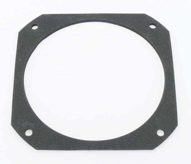

Gasket FRS 10 WP
Foam gasket for watertight mounting of FRS 10 WP on smooth and even surfaces. With an adhesive surface on its rear side. Temperature resistant up to 120 °C.
