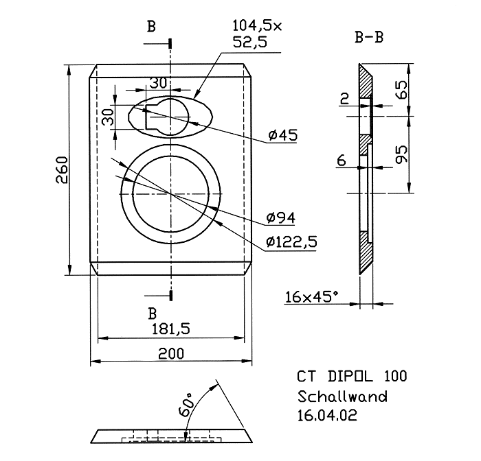

Building instruction
Exploded drawing
Aufbau
The cabinet body uses 16 mm boards. First of all, cut the holes in the boards and apply the bevels. This can be done using an electric jigsaw or hand-held circular saw set to the required angle. Once the cabinet has been completed, apply the milling work for the loudspeaker. Finally, fit the cones.

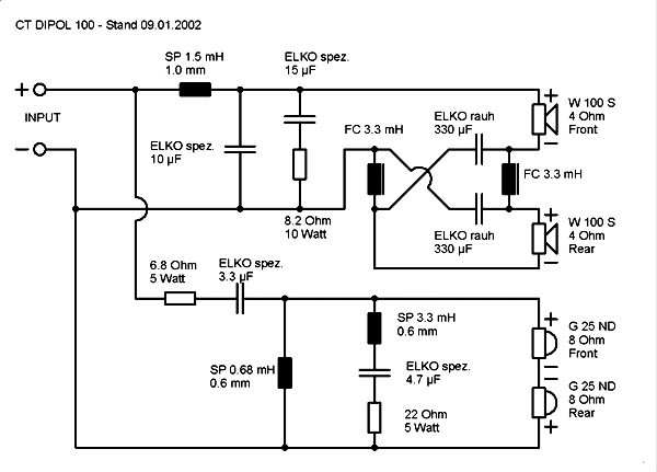

Since the cabinets are relatively small, it is hardly possible to mount the crossover inside the housing. It can, however, simply be wrapped in damping material and placed inside the speaker if the rear wall is not removable.

Cabinet parts list for 1 box
Parts
Size (mm)
Quantity
Material: 16 mm chipboard or MDF
Rear panel:
363 x 260
1
Front and side panel:
200 x 260
3
Top and bottom panel:
141 x 345
2
Partition panel:
141 x 228
1
Crossover
