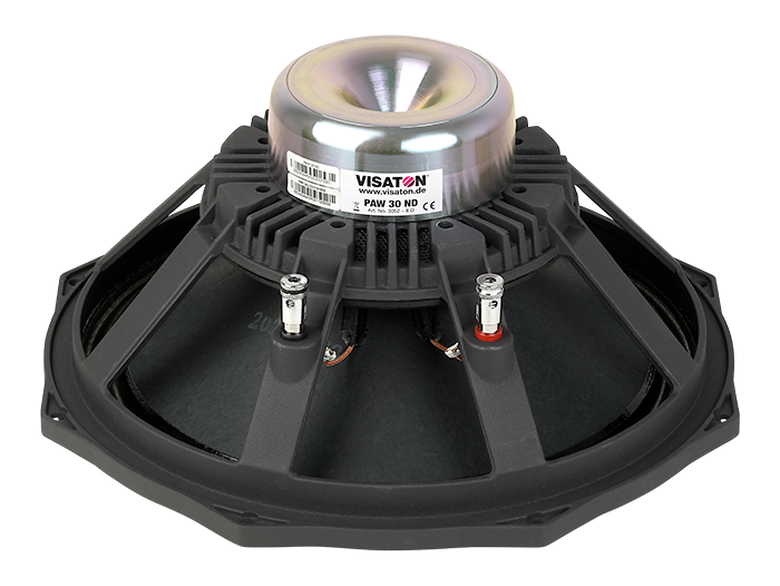

PAW 30 ND - 8 Ohm
Art. No. 3052
30 cm (12") bass midrange for PA applications.
Attributes
  • Octagonal die cast basket
  • Paper membrane
  • 75 mm voice coil for high power handling
  • Til voice coil former
  • Vented spider
  • 10 mm t-yoke venting
  • M shape surround for high excursion
  • Connex spider
  • EVA gasket
  • Neodymium magnet
  • Impedance control ring (aluminum)

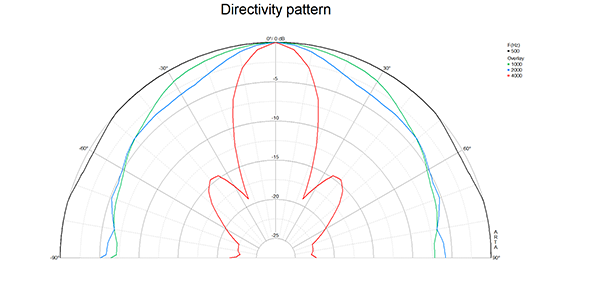

Directivity pattern

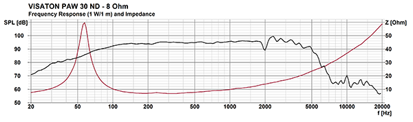

Cm 0.14 mm/N
Rated power 400 W
Nominal impedance Z 8 Ohm
Frequency response fu–5500 Hz
(fu: Lower cut-off frequency depending on cabinet) .
Mean sound pressure level 93 dB (2.83 V/1 m)
Maximum linear displacement +/−4 mm
Excursion limit +/−9 mm
Resonance frequency fs 52 Hz

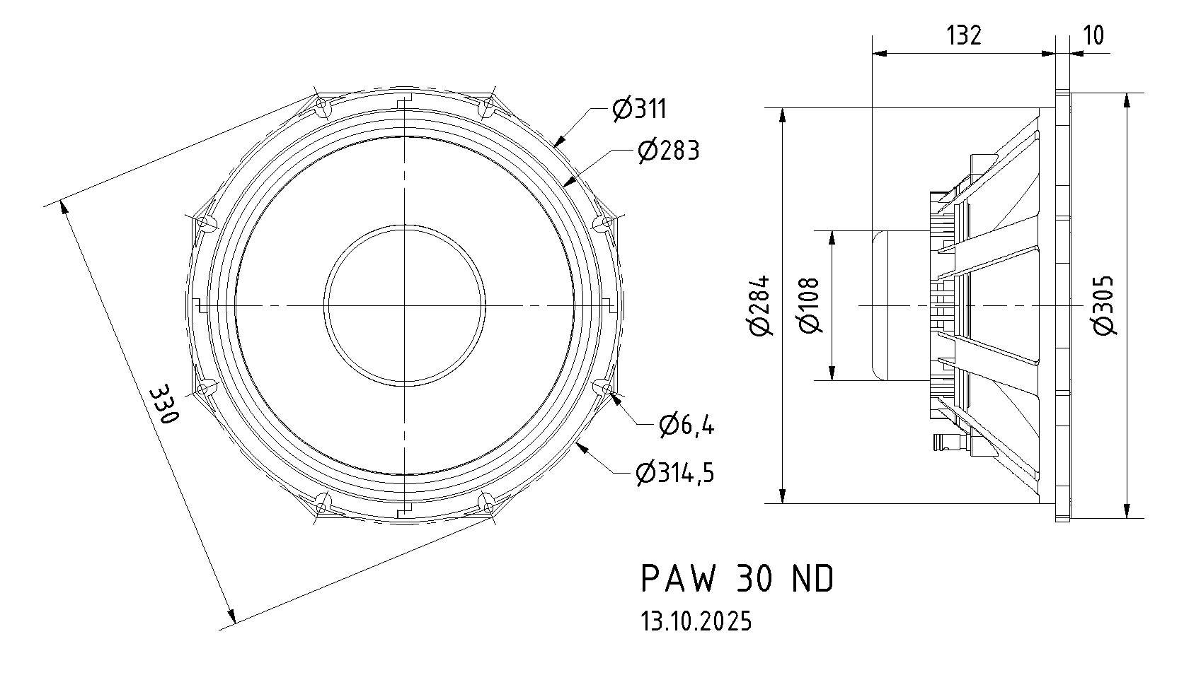

Height of front pole-plate 8 mm
Voice coil diameter 75 mm
Height of winding 16 mm
Cutout diameter 286 mm
Net weight 3.0 kg
