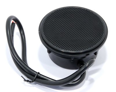

PL 7 RV - 4 Ohm
Art. No. 4475
7 cm (2.5") flush-mounted speaker with a threaded mounting ring at the plastic housing for easy installation in round openings without additional screws. High efficiency at frequencies relevant for speech reproduction. Including 60 cm cable.
Typical applications
  • Dashboards, door panels or other panels in vehicles
Attributes
  • Assembly without additional screws
Technical Data
Sketch
Directivity pattern
Rated power 10 W
Maximum power 20 W
Nominal impedance Z 4 Ohm
Frequency response 400–5000 Hz
Mean sound pressure level 88 dB (1 W/1 m)
Resonance frequency fs 550 Hz
Net weight 0.16 kg
Colour schwarz / black
Length of cable 0.6 m
Cutout diameter 64.5 mm (max. Wandstärke/max. panel thickness 7.5 mm)
Protective system IP 4X
