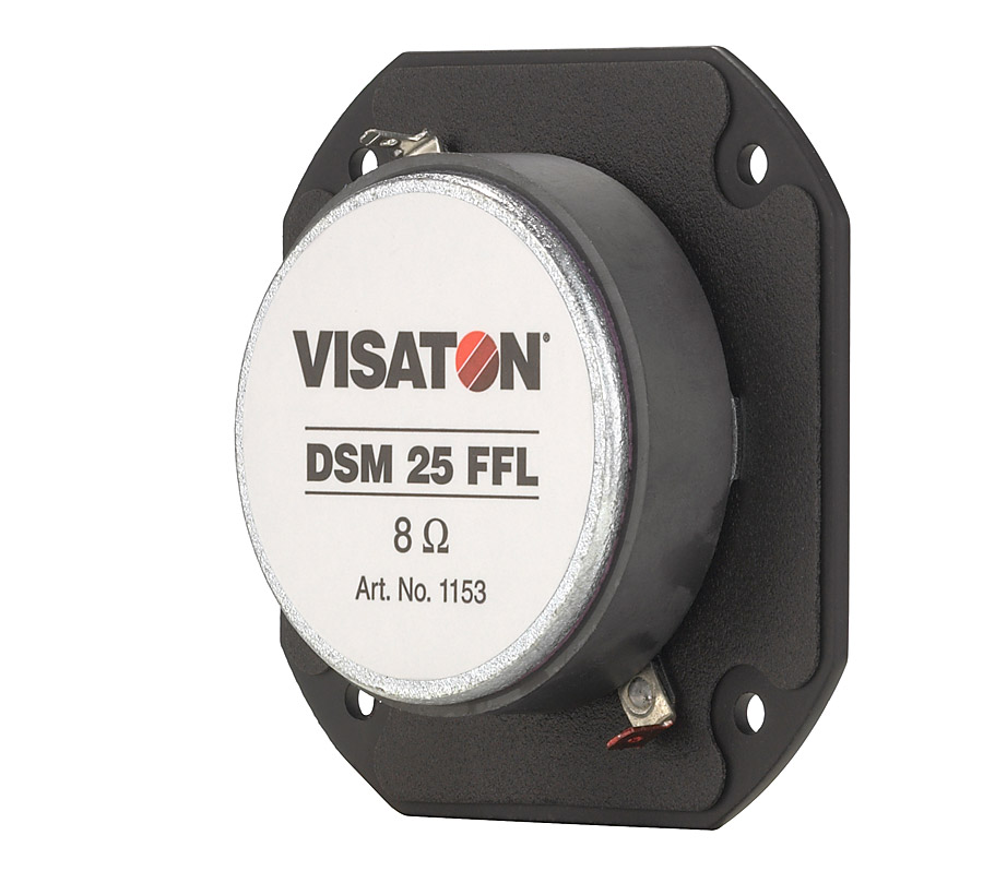

DSM 25 FFL - 8 Ohm
Art. No. 1153

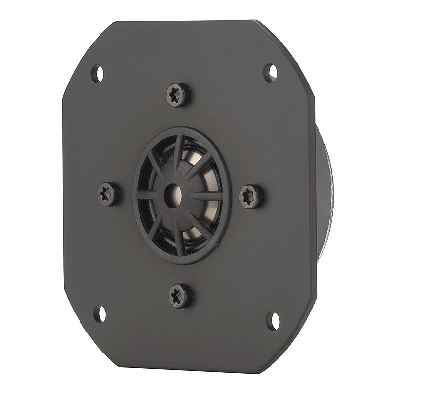

25 mm (1") High-End titanium dome driver for the highrange above 2000 Hz. Due to the enormously strong and ultra-light titanium dome and in conjunction with a highly damped sypronyle surround, linear frequency response and no partial oscillations. Due to the enormously high magnetic flux in the ferrofluid-filled air-gap high efficiency and high power handling are possible.

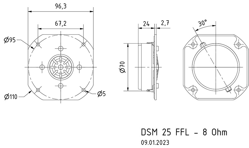

Voice coil diameter 25 mm
Height of winding 2 mm
Cutout diameter 80 mm
Net weight 0.53 kg
D.C. resistance Rdc 5.9 Ohm
Mechanical Q factor Qms 1.83
Electrical Q factor Qes 1.87
Total Q factor Qts 0.92
Effective piston area Sd 4.9 cm²
Connections 4.8 x 0.8 mm (+)/2.8 x 0.8 mm (-)
