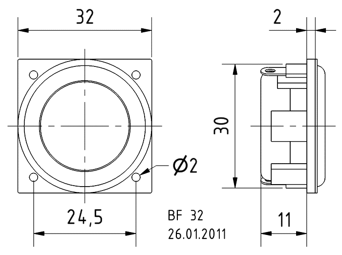

Technical Data
Sketch
Directivity pattern
Rated power 2 W
Maximum power 5 W
Nominal impedance Z 4 Ohm
Frequency response 150–20000 Hz
Mean sound pressure level 78 dB (1 W/1 m)
Resonance frequency fs 280 Hz
Voice coil diameter 20 mm
Height of winding 3 mm
Cutout diameter 31.5 mm
Net weight 0.028 kg
Connections Solder lugs
Temperature range -25 ... 70 °C
