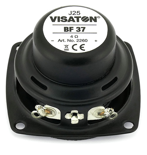

BF 37 - 4 Ohm
Art. No. 2260
3.7 cm (1.5") fullrange speaker with a wide and balanced frequency response and very good low range reproduction. With powerful Neodymium driver and high membrane excursion limit, optimized for small vented enclosures/enclosures with passive radiator. Suitable for applications where slim construction and good music and speech reproduction are requested.
Typical applications
  • Flat TVs
  • Info terminals
  • other compact devices speech and music reproduction

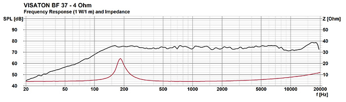

Rated power 5 W
Maximum power 8 W
Nominal impedance Z 4 Ohm
Frequency response 100–20000 Hz
Mean sound pressure level 74 dB (1 W/1 m)
Excursion limit +/-3.4 mm
Resonance frequency fs 155 Hz
Net weight 33.1 g
D.C. resistance Rdc 3.8 Ohm
Mechanical Q factor Qms 5.11
Electrical Q factor Qes 0.86
Total Q factor Qts 0.74
Equivalent volume Vas 0.06 l
Effective piston area Sd 6.2 cm²
Dynamically moved mass Mms 1.0 g
Force factor Bxl 1.99 Tm
Inductance of the voice coil L 0.17 mH
