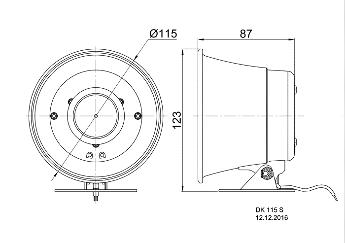

Sketch
Rated power 15 W
Nominal impedance Z 8 Ohm
Frequency response 700–15000 Hz
Mean sound pressure level 101 dB (1 W/1 m)
Net weight 0.45 kg
Max. sound pressure level 112 dB (15 W/1 m)
Length of cable 0.35 m
Protective system IP 66
Temperature range −40 ... 70 °C
