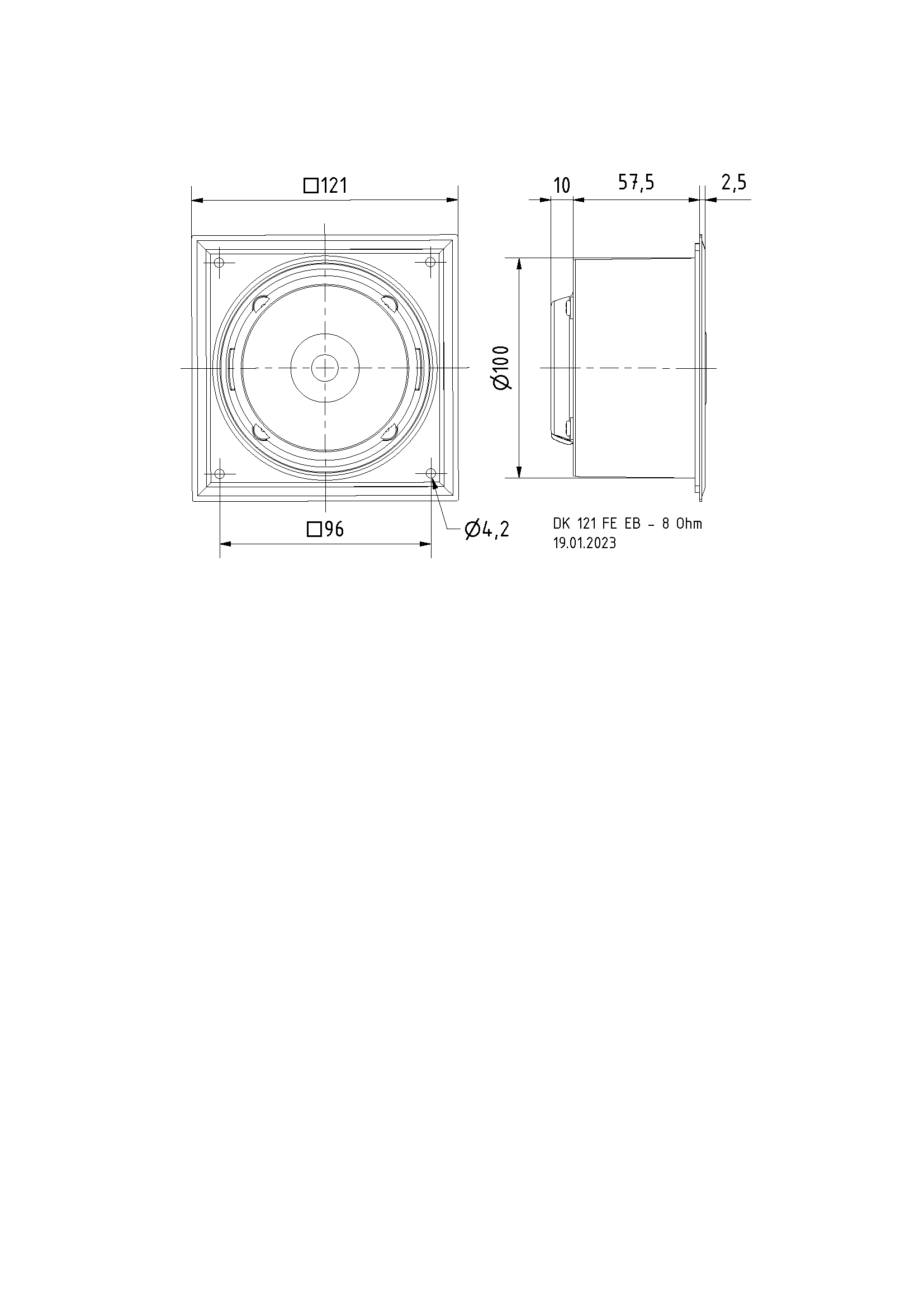

Sketch

Rated power 10 W
Maximum power 15 W
Nominal impedance Z 8 Ohm
Frequency response 620–5000 Hz
Mean sound pressure level 100 dB (1 W/1 m)
Opening angle (-6 dB) 69°/4000 Hz
Net weight 0.61 kg
Sound pressure level 104 dB (1W/1 m) @ 1100 Hz
Connections white (+); brown (-)
Length of cable 1.0 m
Protective system IP 67 IP 66
Temperature range –25 ... 70 °C
