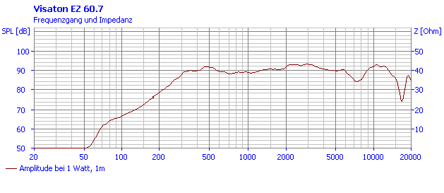

Frequency response 230–20000 Hz
Mean sound pressure level 92 dB (1 W/1 m)

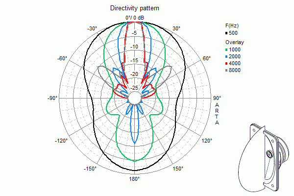

Opening angle (-6 dB) 122°/4000 Hz hor. / 12°/4000 Hz ver.
Net weight 3.1 kg
Transformer matching 30 W/ 15 W/7.5 W
Sound pressure level 95 dB (1 W/1 m)@ 5500 Hz
Max. sound pressure level 107 dB (30 W/1 m)
