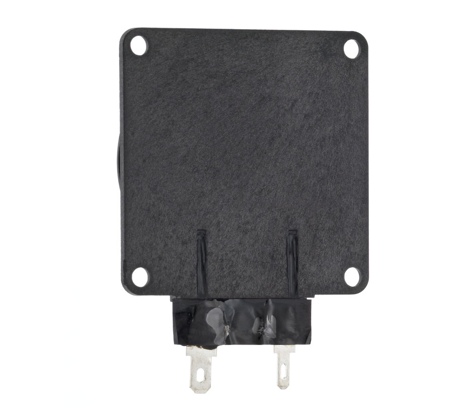

EX 60 S - 8 Ohm
Art. No. 4506
Electro dynamical exciter for stimulating bending waves on plates. The unit can be attached to the surface of the plate by gluing or screwing.

Technical Data
Sketch
Maximum power 25 W *)
Nominal impedance Z 8 Ohm
Voice coil diameter 32.5 mm
Net weight 0.12 kg
Connections 4.8 x 0.8 mm (+)/2.8 x 0.8 mm (-)
Temperature range –25 ... 70 °C
*) Maximum long term power according to DIN EN 60268-5
