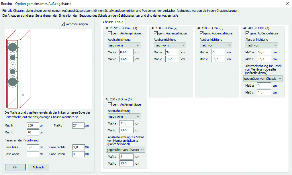

– Takes account of diffraction at the baffle

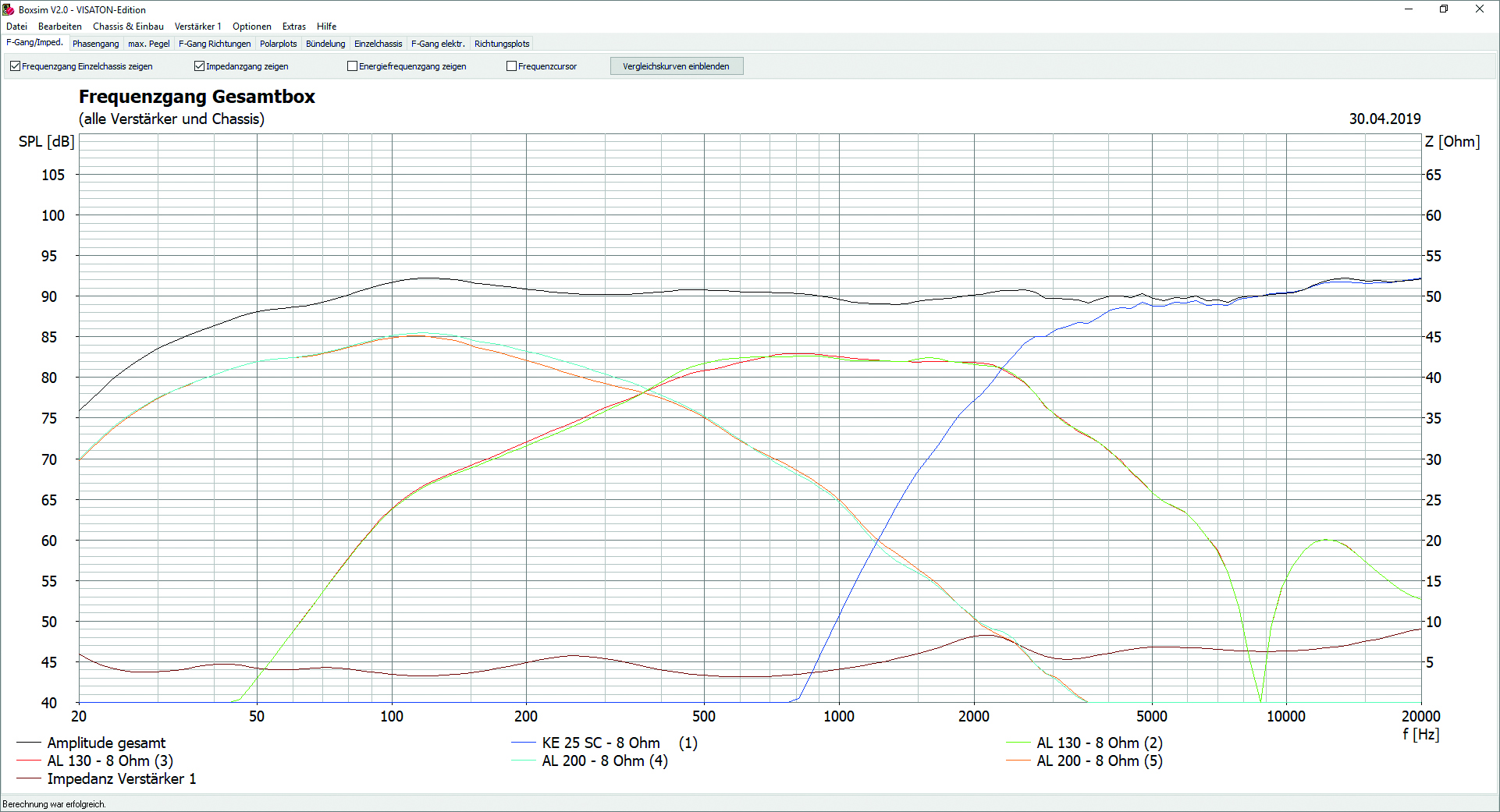

– Frequency response along the axis and in over 20 other directions
– Phase response is calculated separately for each driver
– Separate impedance response for each amplifier output
– Beaming effect and energy frequency response

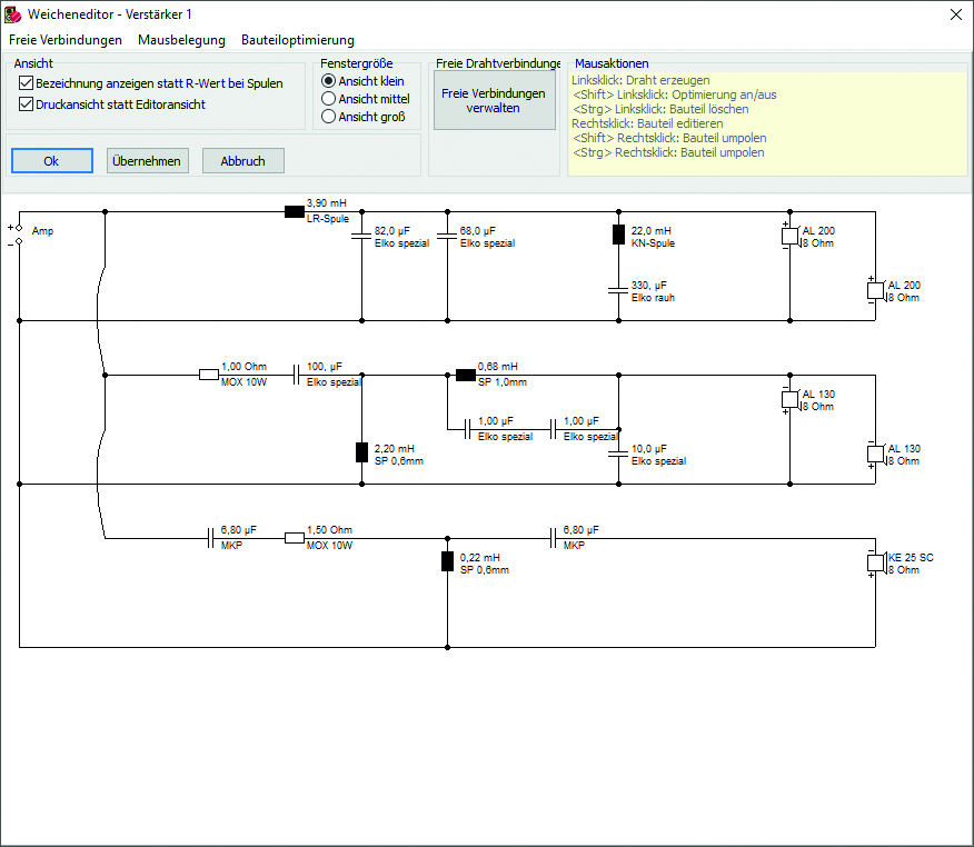

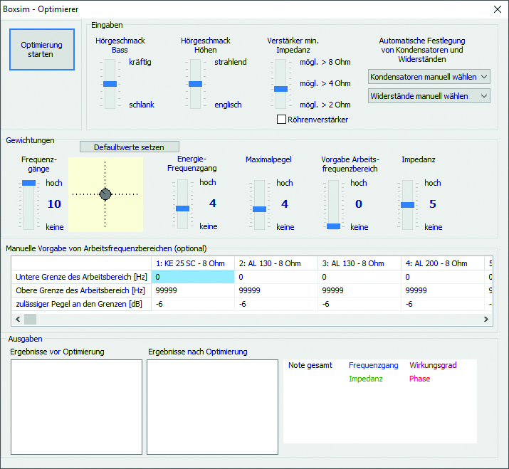

– Crossover editor with freely configurable component positioning and automatic crossover optimiser
– Cabinet variants: enclosed, bass reflex, bandpass, biventilated bandpass
