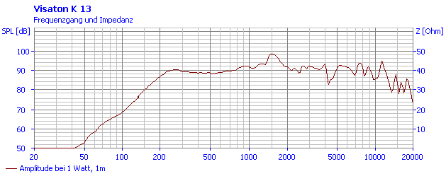

Technical Data
Sketch
Directivity pattern
Rated power 25 W
Maximum power 40 W
Nominal impedance Z 8 Ohm
Frequency response 150–18000 Hz
Mean sound pressure level 91 dB (1 W/1 m)
Opening angle (-6 dB) 57°/4000 Hz
Net weight 1.65 kg
Transformer matching 25 W/12.5 W/6.25 W/8 Ohm
Sound pressure level 97 dB (1 W/1 m)@ 1513 Hz
Max. sound pressure level 105 dB (25 W/1 m)
Length of cable 5 m
Protective system IP 44
Temperature range –25 ... 70 °C
