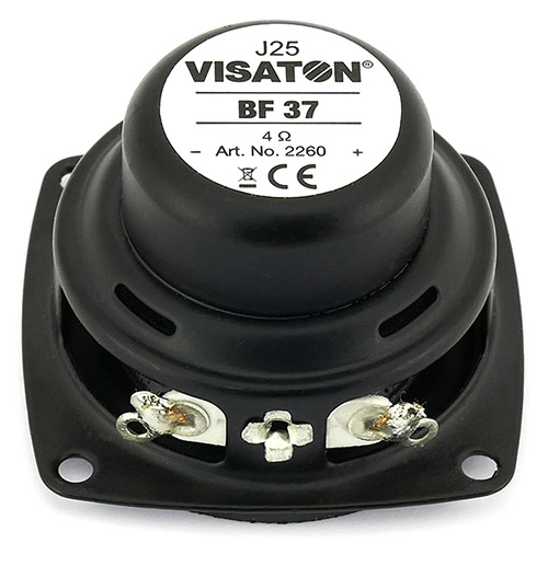

BF 37 - 4 Ohm
Art. No. 2260
3.7 cm (1.5") fullrange speaker with a wide and balanced frequency response and very good low range reproduction. With powerful Neodymium driver and high membrane excursion limit, optimized for small vented enclosures/enclosures with passive radiator. Suitable for applications where slim construction and good music and speech reproduction are requested.
Typical applications
  • Flat TVs
  • Info terminals
  • other compact devices speech and music reproduction
WEEE-reg. no.: DE 79837685
Industrial prices are available on request.

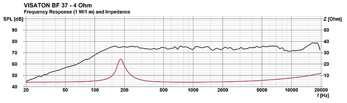

Nennbelastbarkeit 5 W**)
Nennimpedanz Z 4 Ohm
Übertragungsbereich (-10 dB) 100–20000 Hz
Mittlerer Schalldruckpegel 74 dB (1 W/1 m)
Grenzauslenkung +/-3.4 mm
Resonanzfrequenz fs 155 Hz
Gewicht netto 33.1 g
Gleichstromwiderstand Rdc 3.8 Ohm
Mechanischer Q-Faktor Qms 5.11
Elektrischer Q-Faktor Qes 0.86
Gesamt-Q-Faktor Qts 0.74
Äquivalentes Luftnachgiebigkeitsvolumen Vas 0.06 l
Effektive Membranfläche Sd 6.2 cm²
Dynamische bewegte Masse Mms 1.0 g
Antriebsfaktor Bxl 1.99 Tm
Schwingspuleninduktivität L 0.17 mH
Anschlüsse Solder lugs
IP Schutzklasse IP X4 *)
*) IP protection class for front side when built into a sealed enclosure (gluing of the loudspeaker and a front cover (grille) might be necessary)
**) measured in free air configuration with IEC 60268-2 adjusted broadband stimulus signal (fl = 300 Hz, fu = 6000 Hz)
