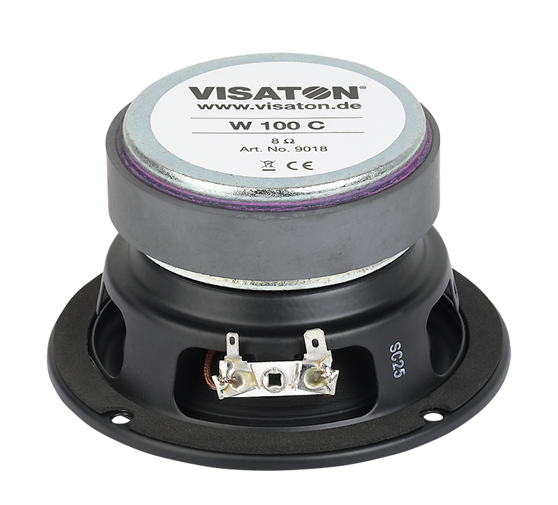

W 100 C - 8 Ohm
Art. No.
9018
Compact and powerful 10 cm woofer for good and powerful bass reproduction even in small subwoofer cabinets.
WEEE-reg. no.: DE 79837685
| Nennbelastbarkeit | 30 W |
| Übertragungsbereich (-10 dB) | 65–11.000 Hz |
| Mittlerer Schalldruckpegel | 84 dB (1 W/1 m) |
| Resonanzfrequenz fs | 60 Hz |
| Schallwandöffnung | 93 mm |
| Gewicht netto | 820 g |
| Anschlüsse | 4.8 x 0.5/2.8 x 0.5 mm |
| Temperaturbereich | -20 ... 70 °C |
