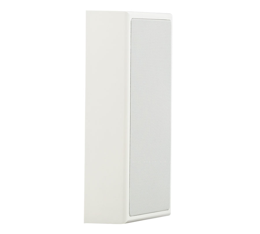

WL 13 P - 100 V
Art. No. 50321
Wall-mounted speaker with a white plastic cabinet and metal grille. Fitted with a full range driver. Good music reproduction and clear speech reproduction properties. Connection to 100 volt network and level trimming by means of spring terminal. Also available: - WL 13 PR - 100 V (with volume cotrol).
Typical applications
  • Wall-mounted speakers in 100 volt networks in public areas, schools, hotels, surgeries etc. for announcements and backgrounds
Attributes
  • 100 V transformer
  • Plastic: ABS V0 (UL 94: V-0)
WEEE-reg. no.: DE 79837685
*Industrial prices are available on request.
Technical Data
Sketch
Directivity pattern
Frequency response 90–16000 Hz
Mean sound pressure level 88 dB (1 W/1 m)
Opening angle (-6 dB) 74°/4000 Hz hor. / 67°/4000 Hz vert.
Net weight 1.15 kg
Transformer matching 6 W/3 W/1.5 W
Sound pressure level 94 dB (1 W/1 m)@ 5312 Hz
Max. sound pressure level 96 dB (6 W/1 m)
Connections Spring terminals
Empfindlichkeit 90 dB (1 W/1 m;700–7000 Hz)
Temperature range 0 ... 70 °C
