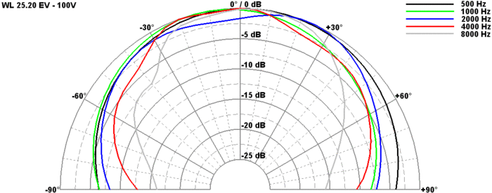

Directivity pattern
Frequency response 120–17000 Hz
Mean sound pressure level 85 dB (1 W/1 m)
Opening angle (-6 dB) 125° hor. (A)/87° vert. (B)/4000 Hz
