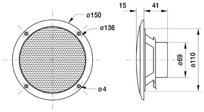

Sketch

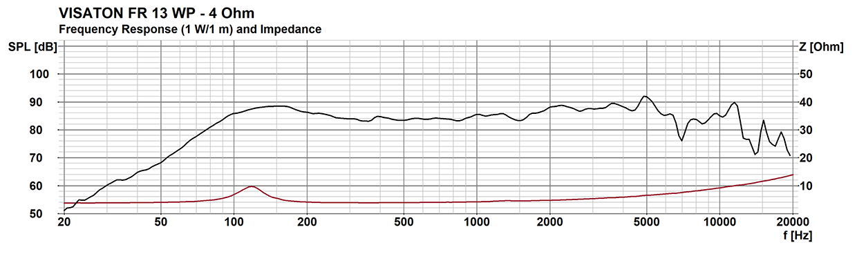

Directivity pattern

Frequency response 70–16000 Hz
Mean sound pressure level 85 dB (1 W/1 m)

Cutout diameter 112 mm
Net weight 0.29 kg
