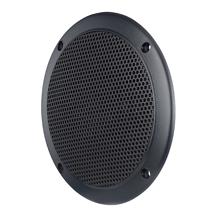

Saltwater resistant 13 cm (5") full-range driver with moulded plastic cone, plastic basket and grille. Absolutely corrosion-resistant and waterproof due to encased magnet and silicon-coated leads. Clear-cut high-range output.
Typical applications
  • Outdoor PA systems
  • Loudspeaker for solariums and damp
  • Boats, ships and open vehicles
Attributes
  • Suitable for outdoor applications
  • Seawater proof
  • Functionally at low temperature according to EN 60068-2-1 (-40 °C; 96 h)
  • Up to the standards of the Germanischer Lloyd (requirements for electrical equipment/low temperature)
  • Plastic: ASA (UL 94:HB; UV-/weather-proof)

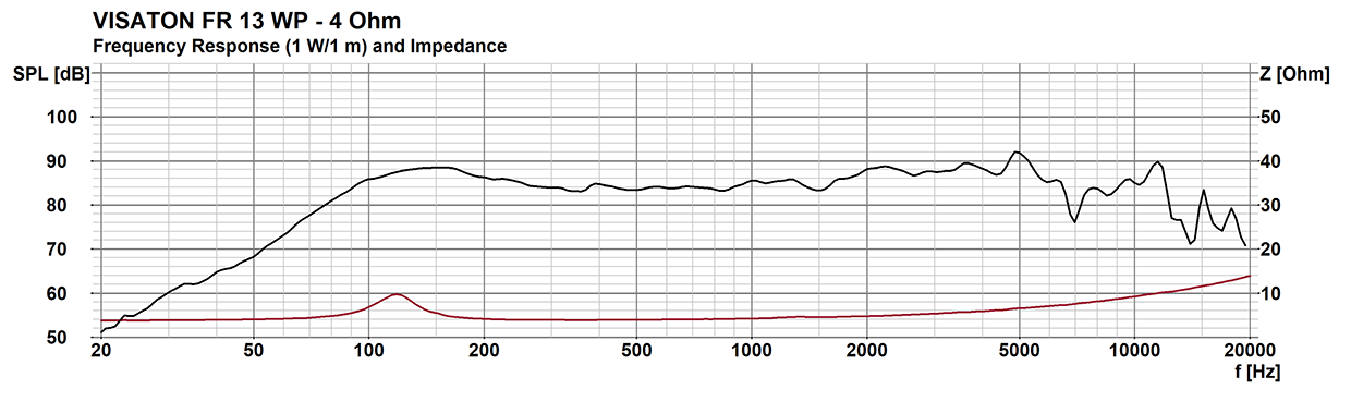

Technical Data
Sketch
Directivity pattern
Rated power 25 W
Maximum power 60 W
Nominal impedance Z 4 Ohm
Frequency response 70–16000 Hz
Mean sound pressure level 85 dB (1 W/1 m)
Opening angle (-6 dB) 69°/4000 Hz
Excursion limit +/−2.5 mm
Resonance frequency fs 100 Hz
Magnetic induction 0.85 T
Magnetic flux 210 µWb
Height of front pole-plate 4 mm
Voice coil diameter 20 mm
Height of winding 5 mm
Cutout diameter 112 mm
Net weight 0.29 kg
D.C. resistance Rdc 3.8 Ohm
Mechanical Q factor Qms 2.49
Electrical Q factor Qes 2.19
Total Q factor Qts 1.17
Equivalent volume Vas 4.4 l
Effective piston area Sd 78 cm²
Dynamically moved mass Mms 4.8 g
Force factor Bxl 2.3 Tm
Inductance of the voice coil L 0.4 mH
Colour black
Connections 4.8 x 0.8 mm (+)/2.8 x 0.8 mm (-)
Protective system IP 65 *) IP 67
Temperature range −40 ... 80 °C
