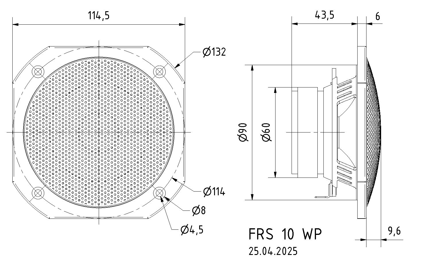

Sketch

Cutout diameter 92 mm
Net weight 0.36 kg

Connections 4.8 x 0.8 mm (+)/2.8 x 0.8 mm (-)
