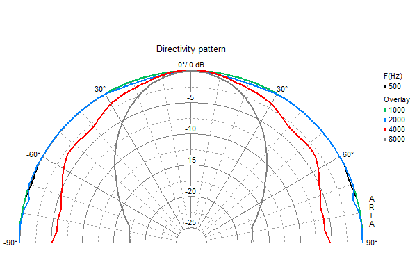

Technical Data
Sketch
Directivity pattern

Opening angle (-6 dB) 150°/4000 Hz
