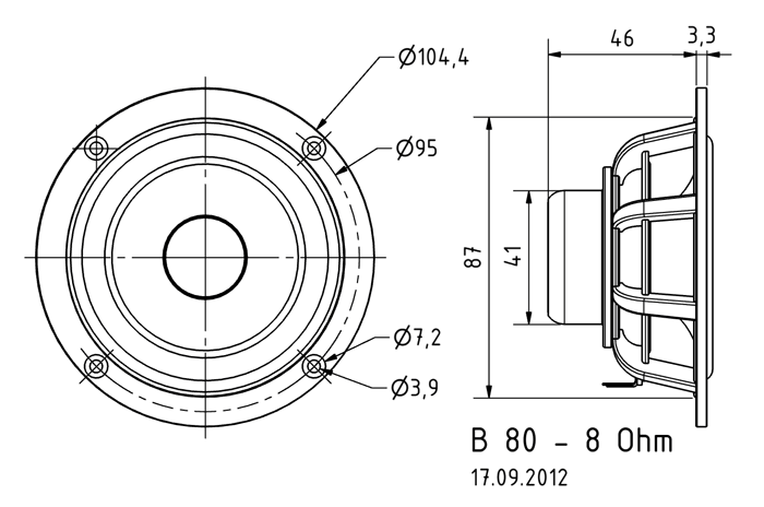

Sketch

Cm 0.87 mm/N
Rated power 30 W
Maximum power 50 W
Nominal impedance Z 8 Ohm
Frequency response 80–20000 Hz
Mean sound pressure level 85 dB (1 W/1 m)
Opening angle (-6 dB) 119°/4000 Hz
Maximum linear displacement 2.2 mm
Resonance frequency fs 110 Hz
Magnetic induction 1.17 T
Magnetic flux 290 µWb
Height of front pole-plate 3 mm
Voice coil diameter 25.5 mm
Height of winding 6.0 mm
Cutout diameter 89 mm
Net weight 0.30 kg
D.C. resistance Rdc 6.6 Ohm
Mechanical Q factor Qms 6.53
Electrical Q factor Qes 0.69
Total Q factor Qts 0.63
Equivalent volume Vas 1.8 l
Effective piston area Sd 38.5 cm²
Dynamically moved mass Mms 2.8 g
Force factor Bxl 4.15 Tm
Connections 5.2 x 0.5 mm (+)/2.8 x 0.5 mm (-)
