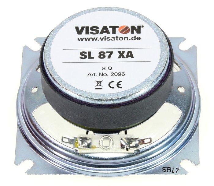

SL 87 XA - 8 Ohm
Art. No. 2096
Waterproof 8 cm (3.3") fullrange speaker with a transparent plastic cone and rubber sealing ring. Very high mean sound pressure level. Optimised for voice and signal output.
*) IP protection class for front side when built into a sealed enclosure (gluing of the loudspeaker might be necessary)
**) 1 m height of water, 16 h
Typical applications
  • Monitoring speaker for electronic devices
  • Outdoor sound reinforcement systems
  • Alarm systems
Attributes
  • UV-resistant
  • weather-resistant
Technical Data
Sketch
Directivity pattern
Rated power 20 W
Maximum power 30 W
Nominal impedance Z 8 Ohm
Frequency response 350–5800 Hz
Mean sound pressure level 94 dB (1 W/1 m)
Opening angle (-6 dB) 142°/4000 Hz
Resonance frequency fs 550 Hz
Height of front pole-plate 3 mm
Voice coil diameter 20 mm
Height of winding 4 mm
Cutout diameter 80 mm
Net weight 0.38 kg
Connections 2.8 x 0.5 mm (+)/2.8 x 0.5 mm (-)
Protective system IP 65 *)IP x8 *) **)
Temperature range −40 ... 70 °C
