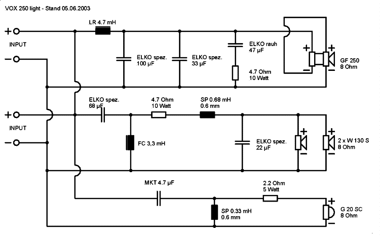

The crossover unit is mounted on the side panel behind the bass port.
