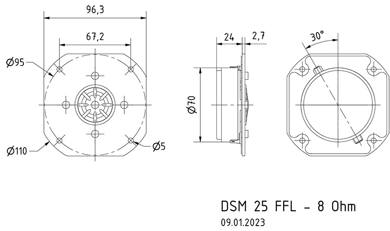

Technical Data
Sketch
Directivity pattern
Waterfall spectrum
Nominal impedance Z 8 Ohm
Frequency response 1000–30000 Hz
Mean sound pressure level 90 dB (1 W/1 m)
Opening angle (-6 dB) 138°/8000 Hz
Resonance frequency fs 1600 Hz
Magnetic induction 1.7 T
Magnetic flux 425 µWb
Height of front pole-plate 2.5 mm
Voice coil diameter 25 mm
Height of winding 2 mm
Cutout diameter 80 mm
Net weight 0.53 kg
D.C. resistance Rdc 5.9 Ohm
Mechanical Q factor Qms 1.83
Electrical Q factor Qes 1.87
Total Q factor Qts 0.92
Effective piston area Sd 4.9 cm²
Connections 4.8 x 0.8 mm (+)/2.8 x 0.8 mm (-)
Peak power handling with high pass 140 W (12 dB/Okt.; 2000 Hz)
Nominal power handling with high pass 80 W (12 dB/Okt.; 2000 Hz)
