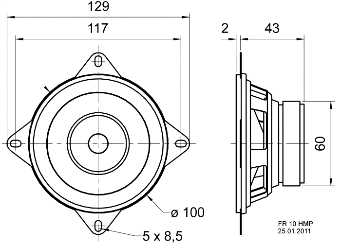

Technical Data
Sketch
Directivity pattern
Rated power 20 W
Maximum power 30 W
Nominal impedance Z 4 Ohm
Frequency response 90–20000 Hz
Mean sound pressure level 86 dB (1 W/1 m)
Opening angle (-6 dB) 87°/4000 Hz
Excursion limit +/−2 mm
Resonance frequency fs 120 Hz
Height of front pole-plate 2 mm
Voice coil diameter 14 mm
Height of winding 5 mm
Cutout diameter 94 mm
Net weight 0.268 kg
Connections 2 x 4.8 x 0.8 mm (+)/2.8 x 0.8 mm (-)
Protective system IP 64 *)
Temperature range –25 ... 70 °C
