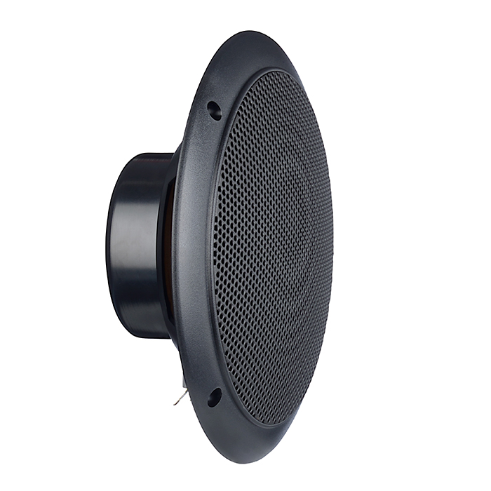

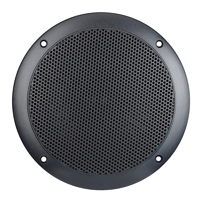

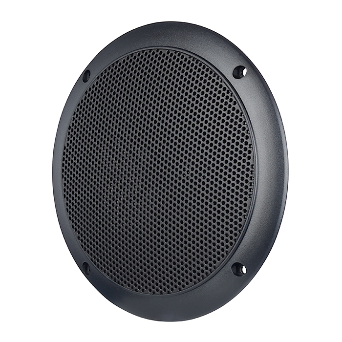

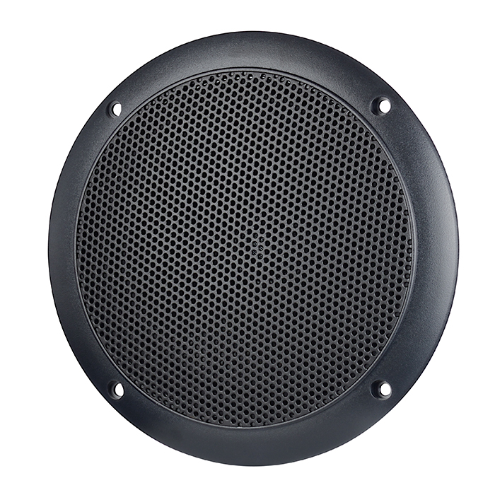

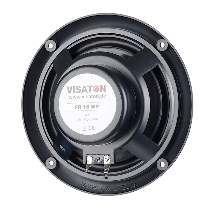

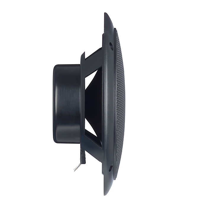

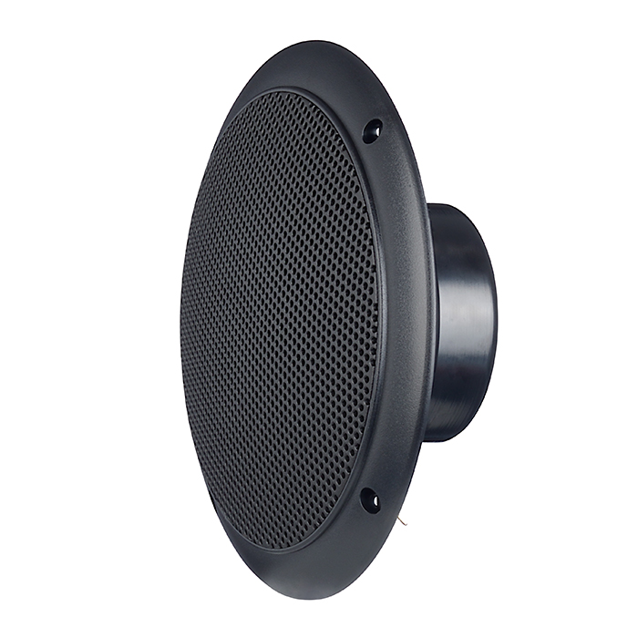

Water resistant 16 cm (6.5") full-range speaker with moulded plastic cone, plastic basket and grille. Absolutely corrosion-resistant and waterproof due to encased magnet and silicon-coated leads. Black colour.
Typical applications
  • Outdoor PA systems
  • Loudspeaker for solariums and damp
  • Boats, ships and open vehicles
Attributes
  • Waterproof
  • Functionally at low temperature according to EN 60068-2-1 (-40 °C; 96 h)
  • Up to the standards of the Germanischer Lloyd (requirements for electrical equipment/low temperature)
  • UV-resistant
  • weather-resistant
Technical Data
Sketch
Directivity pattern
Rated power 30 W
Nominal impedance Z 4 Ohm
Frequency response 60–15000 Hz
Mean sound pressure level 86 dB (1 W/1 m)
Opening angle (-6 dB) 46°/4000 Hz
Excursion limit 3 +/- 0.65 mm
Resonance frequency fs 85 Hz
Magnetic induction 1.0 T
Magnetic flux 250 µWb
Height of front pole-plate 4 mm
Voice coil diameter 20 mm
Height of winding 5.3 ±0.4 mm
Cutout diameter 143 mm
Net weight 0.46 kg
D.C. resistance Rdc 3.7 Ohm
Mechanical Q factor Qms 2.99
Electrical Q factor Qes 1.55
Total Q factor Qts 1.02
Equivalent volume Vas 10 l
Effective piston area Sd 130 cm²
Dynamically moved mass Mms 8.4 g
Force factor Bxl 3.2 Tm
Inductance of the voice coil L 0.4 mH
Colour schwarz/black

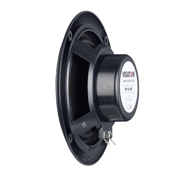

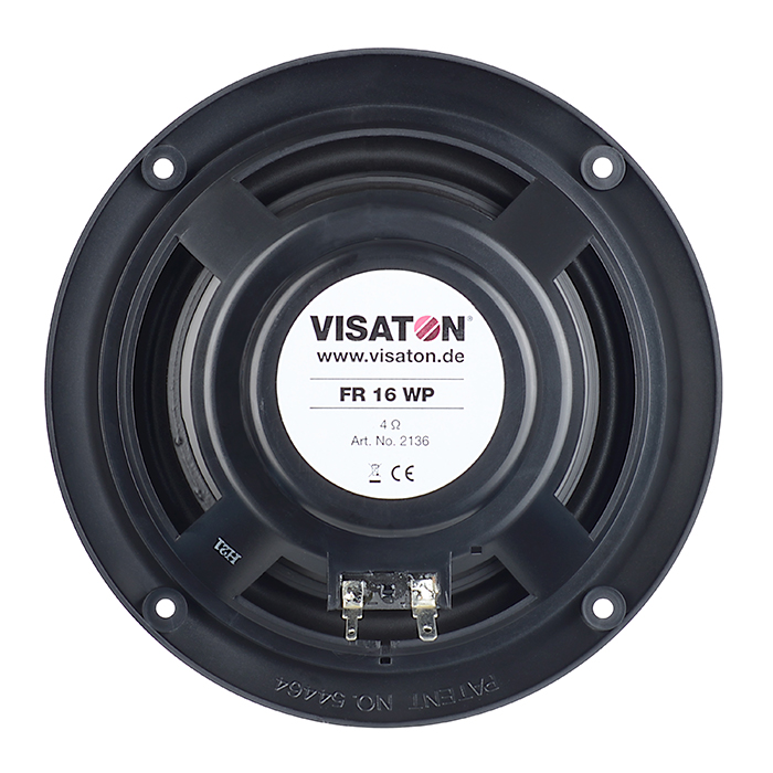

Connections 4.8 x 0.8 mm (+)/2.8 x 0.8 mm (-)
Protective system IP 65 *) IP 67 *)
Temperature range −40 ... 80 °C
