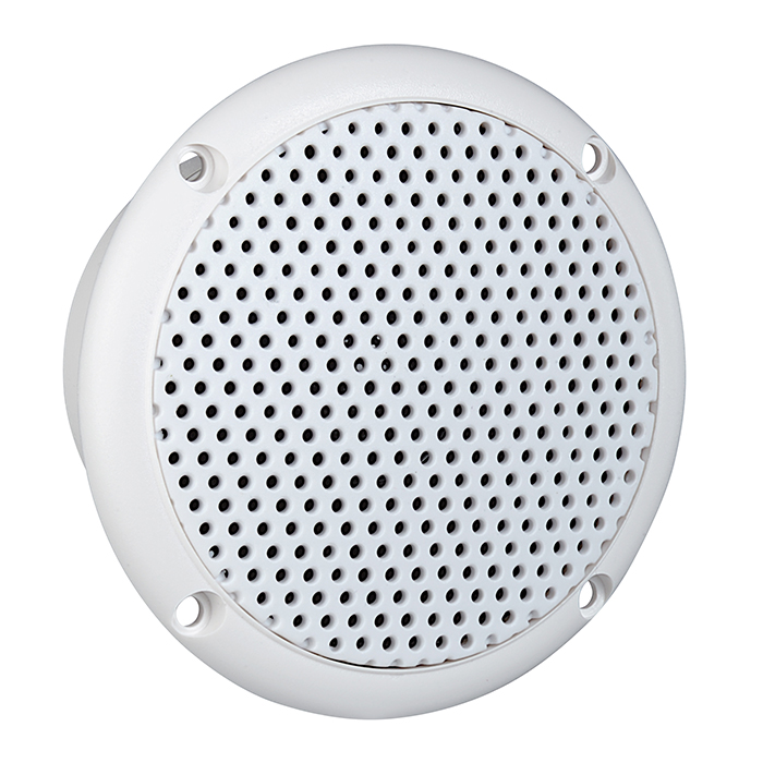

FR 8 WP - 8 Ohm (white)
Art. No. 2129

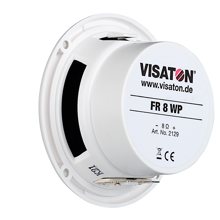

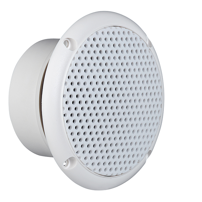

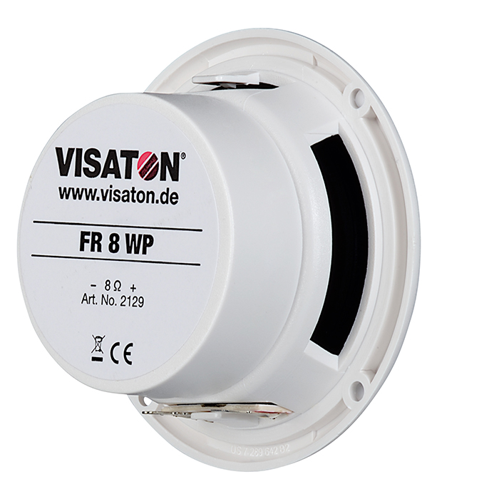

Saltwater resistant 8 cm (3.3") full-range speaker with moulded plastic cone, plastic basket and grille. Absolutely corrosion-resistant and waterproof due to encased magnet and silicon-coated leads. Clear-cut high-range output.
Typical applications
  • Outdoor PA systems
  • Loudspeaker for solariums and damp
  • Boats, ships and open vehicles
Attributes
  • Seawater proof
  • Functionally at low temperature according to EN 60068-2-1 (-40 °C; 96 h)
  • Up to the standards of the Germanischer Lloyd (requirements for electrical equipment/low temperature)
  • Plastic: ASA (UL 94:HB; UV-/weather-proof)
  • Ball-resistant
Technical Data
Sketch
Directivity pattern
Rated power 15 W
Maximum power 25 W
Nominal impedance Z 8 Ohm
Frequency response 100–20000 Hz
Mean sound pressure level 84 dB (1 W/1 m)
Opening angle (-6 dB) 114°/4000 Hz
Excursion limit +/−3 mm
Resonance frequency fs 158 Hz
Magnetic induction 1 T
Magnetic flux 190 µWb
Height of front pole-plate 3 mm
Voice coil diameter 20 mm
Height of winding 4 mm
Cutout diameter 74 mm
Net weight 0.23 kg
Colour white
Connections 5.2 x 0.5 mm (+)/2.8 x 0.5 mm (-)
Protective system IP 65 *)
Temperature range −40 ... 80 °C
