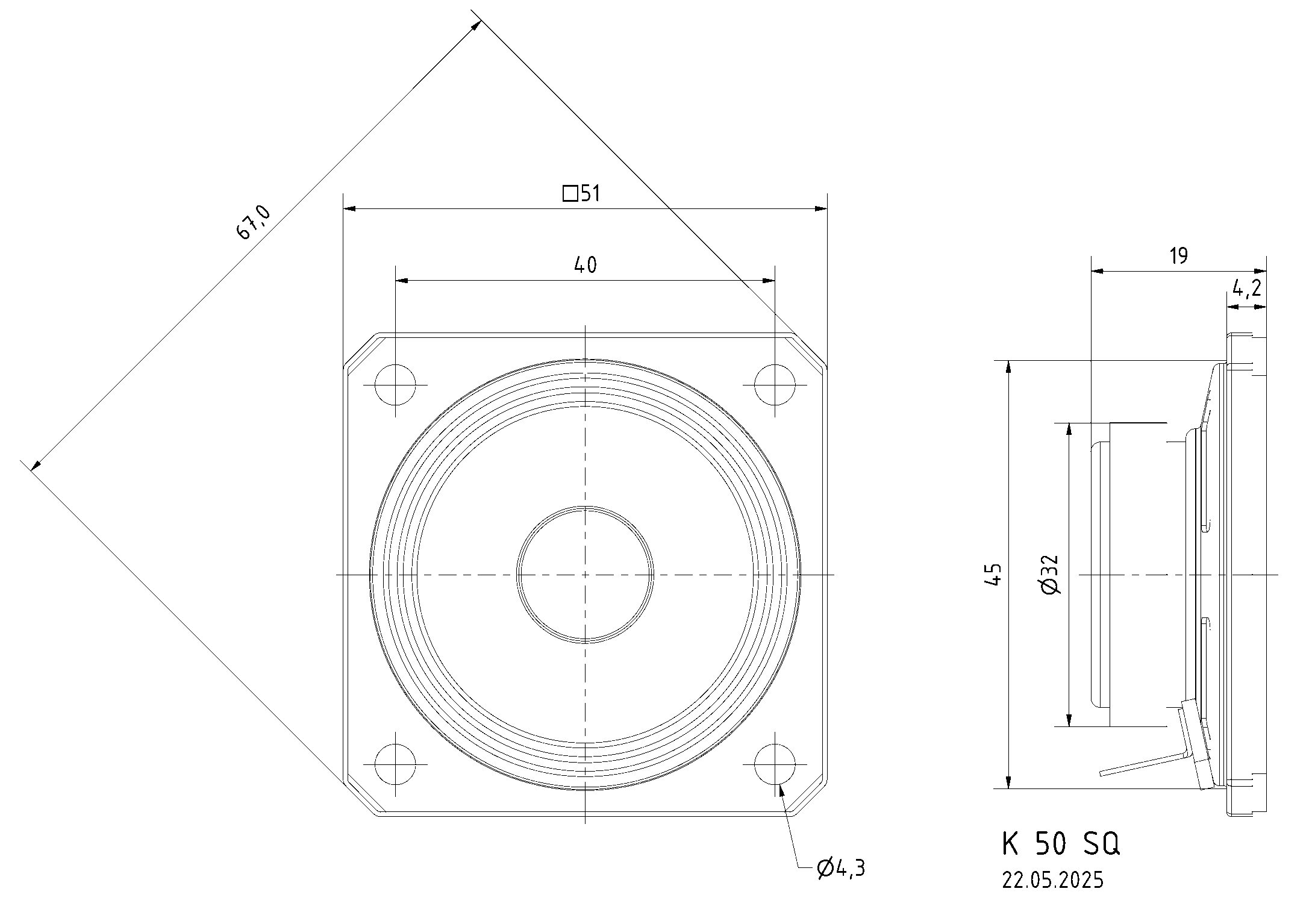

5 cm (2") miniature speaker with plastic diaphragm, square metal basket with 4 mounting holes and foam gasket. 2.8 x 0.5 mm contact pin. Thanks to its compact dimensions, suitable for signal output in machines and other equipment where space is at a premium.

Sketch

Rated power 2 W
Nominal impedance Z 8 Ohm
Frequency response 250–10000 Hz
Mean sound pressure level 83 dB (1 W/1 m)
Opening angle (-6 dB) 180°/4000 Hz
Excursion limit +/−1 mm
Resonance frequency fs 480 Hz
Height of front pole-plate 2 mm
Voice coil diameter 14 mm
Height of winding 3 mm
Cutout diameter 45 mm
Net weight 0.05 kg
D.C. resistance Rdc 7.3 Ohm
Mechanical Q factor Qms 6.42
Electrical Q factor Qes 7.32
Total Q factor Qts 3.42
Equivalent volume Vas 0.06 l
Effective piston area Sd 12.5 cm²
Dynamically moved mass Mms 0.4 g
Force factor Bxl 1.12 T m
Connections 2.8 x 0.5 mm (+)/2.8 x 0.5 mm (-)
Protective system IP 65 *) IP 67 *)
Temperature range −40 ... 80 °C
