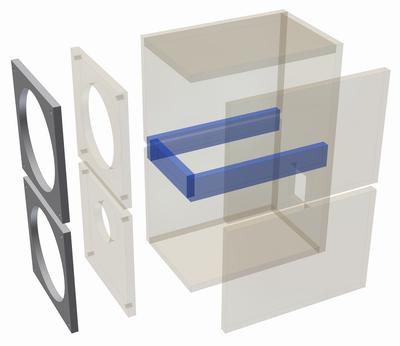

Exploded drawing
Aufbau
The boards for the subwoofer are glued (butt jointed) as shown in the drawing and subsequently the openings cut out. The fabric tensioning frame is fixed to the cabinet using wooden frame plugs.

Cabinet parts list for 1 box
Parts
Size (mm)
Quantity
Material: 19 mm chipboard or MDF
Front panel
270 x 270
2
Side panel
381 x 270
4
Rear panel
559 x 232
1
Top and bottom panel
362 x 232
2
Frame
362 x 57
2
Frame
194 x 57
1
Material: 16 mm MDF
Grille board
265 x 265
2
