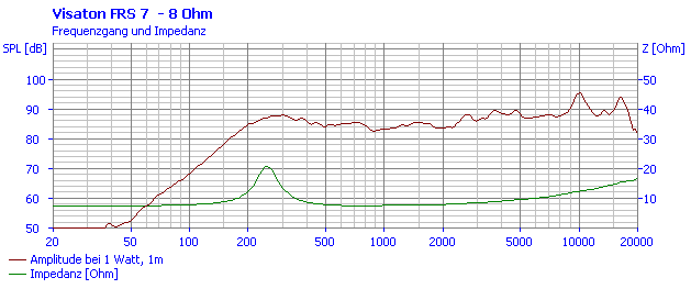

Technical Data
Sketch
Directivity pattern
Rated power 8 W
Maximum power 15 W
Nominal impedance Z 8 Ohm
Frequency response 200–20000 Hz
Mean sound pressure level 88 dB (1 W/1 m)
Opening angle (-6 dB) 149°/4000 Hz
Excursion limit +/−1.5 mm
Resonance frequency fs 250 Hz
Magnetic induction 1.2 T
Magnetic flux 160 µWb
Height of front pole-plate 2 mm
Voice coil diameter 14 mm
Height of winding 3.5 mm
Cutout diameter 61 mm
Net weight 0.2 kg
D.C. resistance Rdc 7.2 Ohm
Mechanical Q factor Qms 3.32
Electrical Q factor Qes 2.08
Total Q factor Qts 1.28
Equivalent volume Vas 0.3 l
Effective piston area Sd 22 cm²
Dynamically moved mass Mms 0.8 g
Force factor Bxl 2.1 Tm
Inductance of the voice coil L 0.6 mH
Connections 2.8 x 0.5 mm (+)/2.8 x 0.5 mm (-)
Protective system IP 64 *)
Temperature range -40 ... 100 °C
