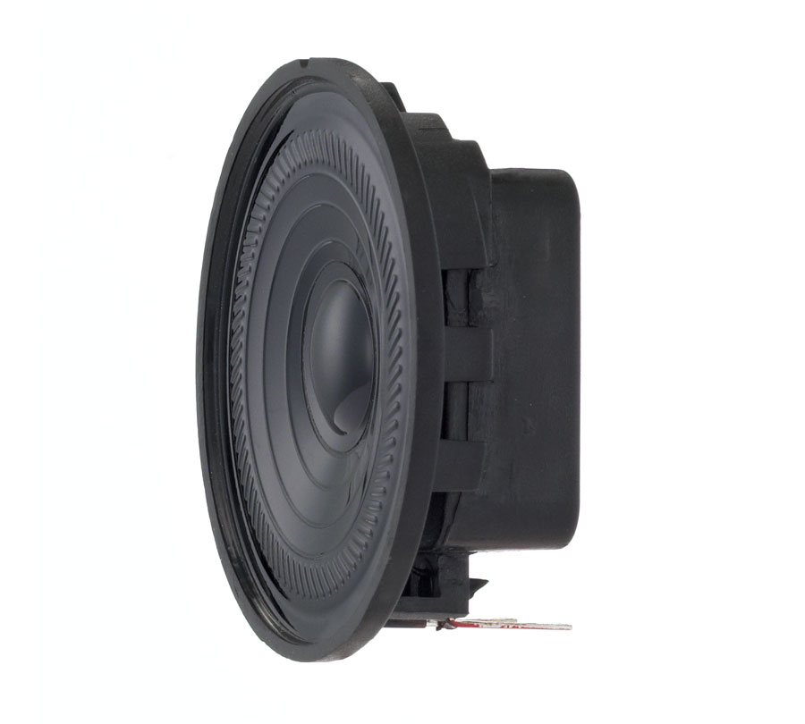

6.4 cm (2.5") full-range speaker with a plastic basket and plastic diaphragm. Broad frequency response and good voice reproduction. Particularly well suited to outdoor applications and where ambient conditions are generally unfavourable (e.g. high humidity). Version with different orientation of the terminals: see K 64 WPT - 8 Ohm
Typical applications
  • Monitoring speaker for electronic devices
  • Monitoring speaker for outdoor systems
Attributes
  • weather-resistant
  • UV-resistant
  • Plastic: ABS (basket; UL 94:HB); Mylar (diapraghm)
  • Functionally at cold according to EN 60068-2-1/EN 50155
  • Cold storage (-40 °C) according to EN 60068-2-1/EN 50155
  • Functionally at damp heat (cyclic) according to EN 60068-2-3/EN 50155
  • Functionally at dry heat according to EN 60068-2-2/EN 50155
Technical Data
Sketch
Directivity pattern
Rated power 2 W
Maximum power 3 W
Nominal impedance Z 8 Ohm
Frequency response 200–15000 Hz
Mean sound pressure level 86 dB (1 W/1 m)
Opening angle (-6 dB) 109°/4000 Hz
Excursion limit +/−1 mm
Resonance frequency fs 300 Hz
Magnetic induction 0.7 T
Magnetic flux 45 µWb
Height of front pole-plate 2 mm
Voice coil diameter 10 mm
Height of winding 2.5 mm
Cutout diameter 60 mm
Net weight 0.05 kg
Connections 2.8 x 0.5 mm (+)/2.8 x 0.5 mm (-)
Protective system IP 65 *)
Temperature range −40 ... 80 °C
