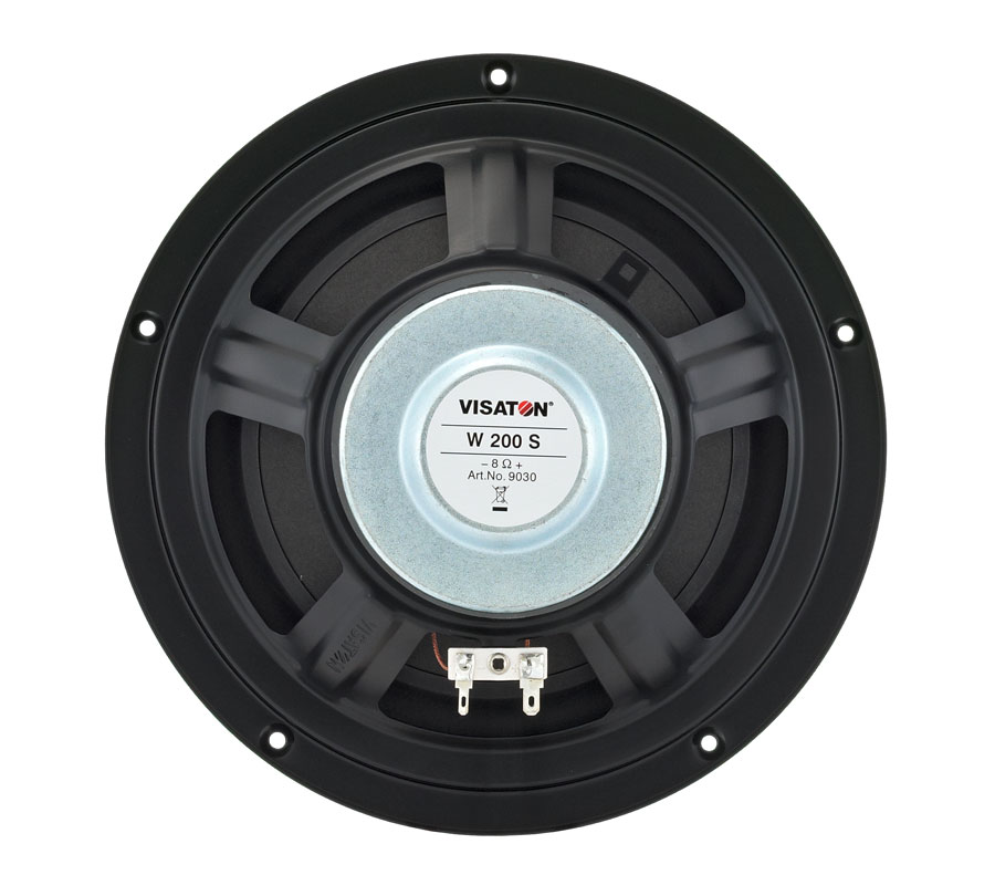

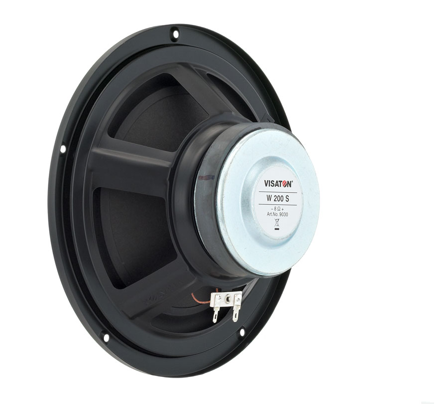

W 200 S - 8 Ohm
Art. No. 9030
20 cm (8") HiFi woofer with strong drive, extended rear pole plate and 35 mm voice-coil for high power handling. Elastic rubber surround and coated paper cone.   Recommended cabinets: Volume/Principle BR-Channel fb fc/QTC 15 l/closed  -  - 70 Hz/0,7 20 l/bass reflex BR 19.24 (length 14 cm) 45 Hz  - 30 l/bass reflex BR 19.24 (length 11 cm) 39 Hz  - 50 l/bass reflex BR 15.34 (length 13 cm) 33 Hz  -
