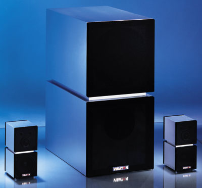

NANO is the name of the latest miniature magic made by VISATON. This system, equipped with the tiniest of satellite speakers, sounds as uncompromisingly good as many far larger upright systems. The high frequency range is designed as a dipole and, in conjunction with the mid- and bass frequencies, creates a well-rounded, airy overall sound. The balanced frequency response across the entire frequency range, one hitherto not achievable by this kind of system, is a feature of the Nano system.
The tiny satellites must be considered "sitting room friendly" because they are so compact, they'll fit in any shelving system. The subwoofer cabinet, equipped with the well-known high-end GF 200 driver, has been designed to match the satellites and simply disappears in a corner of the room.
The BR 25.50 bass reflex tube with its flow-optimised, curved trumpet vent, contributes to the good overall sound. The subwoofer cannot be located due to its 18 dB filter and separation at 150 Hz. A high-pass system and reflex balance enable the two tiny, magnetically screen satellites to produce remarkably dynamic sound. They can, therefore, also be used as centre or surround speakers for Dolby Surround systems at home.
