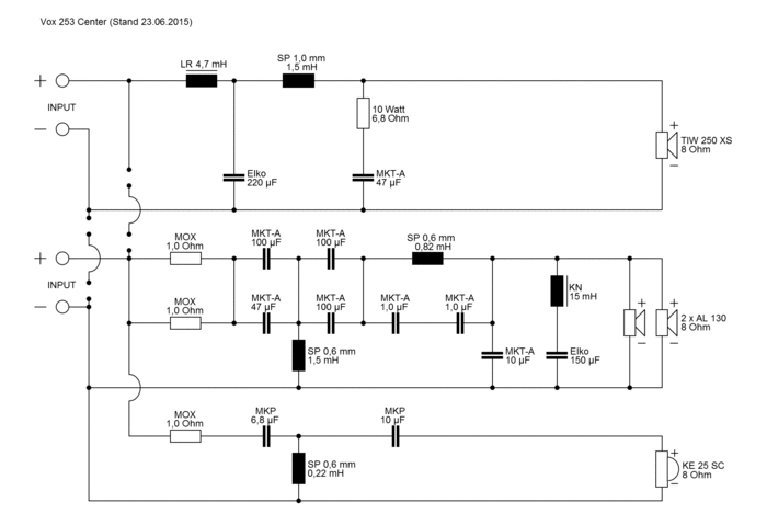

The crossover unit is mounted on the rear wall beside the bass port.

Crossover
