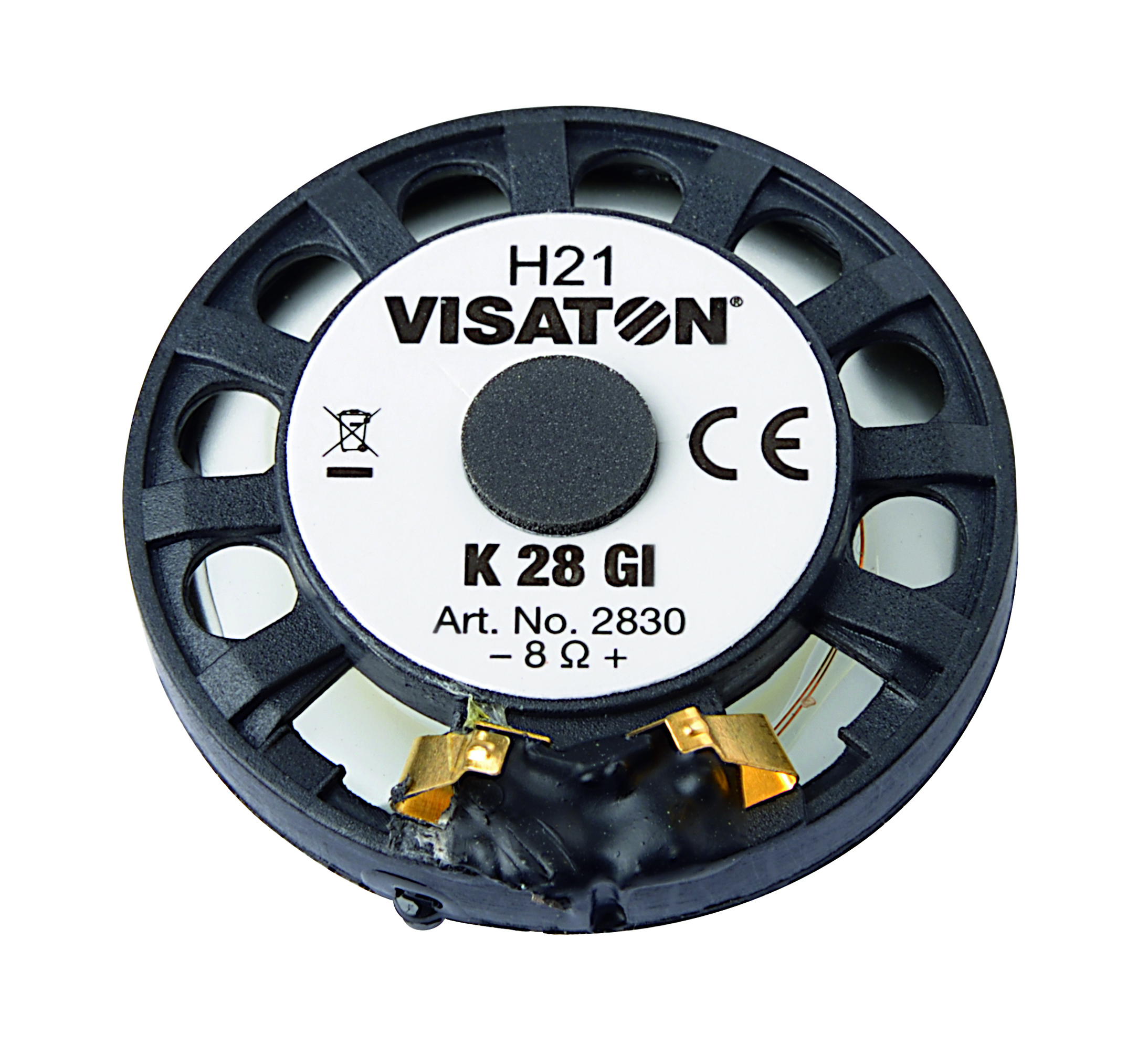

2.8 cm (1.1") miniature speaker with polycarbonate membrane and round plastic basket. Thanks to its dimension, suitable for signal output in equipment, where space is at a premium. Connection via spring contacts on rear side.

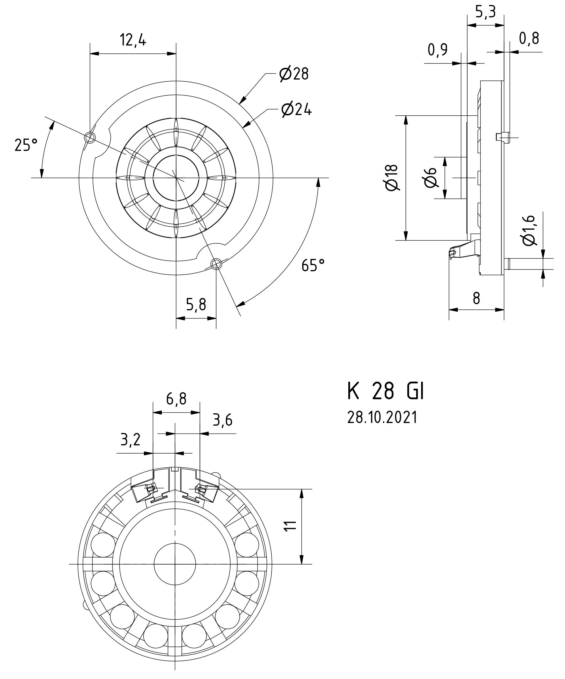

Sketch

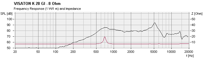

Frequency response 450–7000 Hz
Mean sound pressure level 82 dB (1 W/1 m)
Resonance frequency fs 730 Hz
