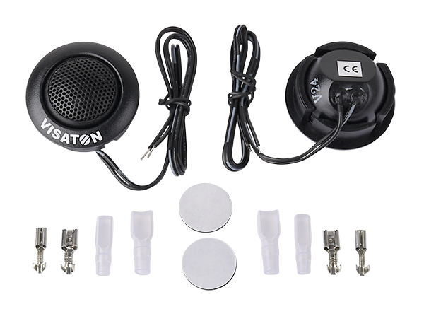

Very compact 13 mm (0.5") ferro-fluid cooled tweeter with a polycarbonate cone, featuring an absolutely linear frequency response. Crisp high-range reproduction and excellent omnidirectional sound distribution. Tweeter in low to medium-output 2- or 3-way systems or as an additional tweeter. Can be surface or flush mounted. Especially suitable for mounting in confined spaces (e.g. mirror vicinity and door handles).Accessories: Mounting ring and connecting cables included

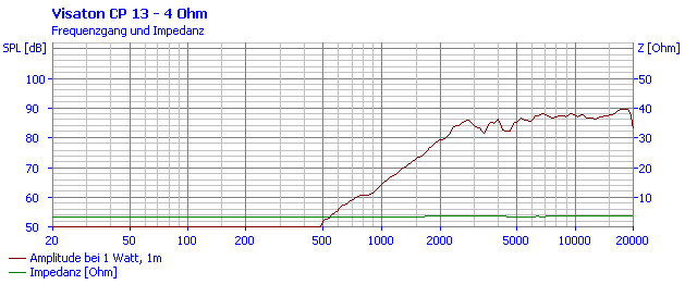

Nominal impedance Z 4 Ohm
Frequency response 1700–22000 Hz
Mean sound pressure level 86 dB (1 W/1 m)
Opening angle (-6 dB) 180°/8000 Hz
Resonance frequency fs 2400 Hz
Magnetic induction 0.8 T
Magnetic flux 65 µWb
Voice coil diameter 13 mm
Height of winding 1.5 mm
Cutout diameter 33.5 mm
Net weight 0.033 kg
D.C. resistance Rdc 3.3 Ohm
Inductance of the voice coil L 0.4 mH
Peak power handling with high pass 100 W (12 dB/Okt.; 6000 Hz)
Nominal power handling with high pass 60 W (12 dB/Okt.; 6000 Hz)
